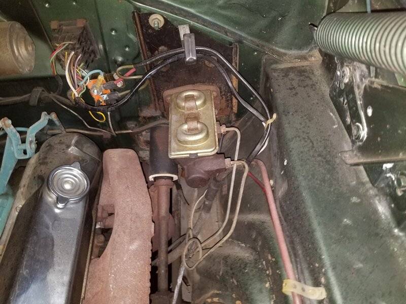

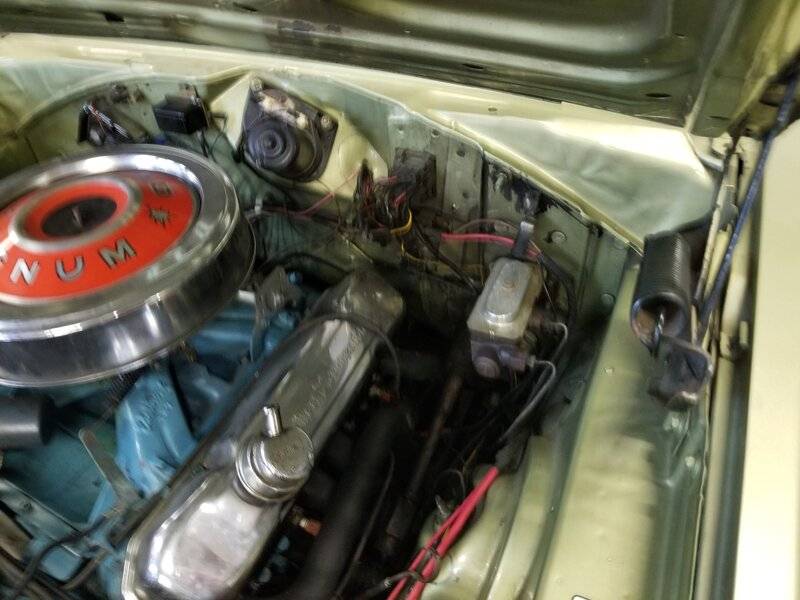

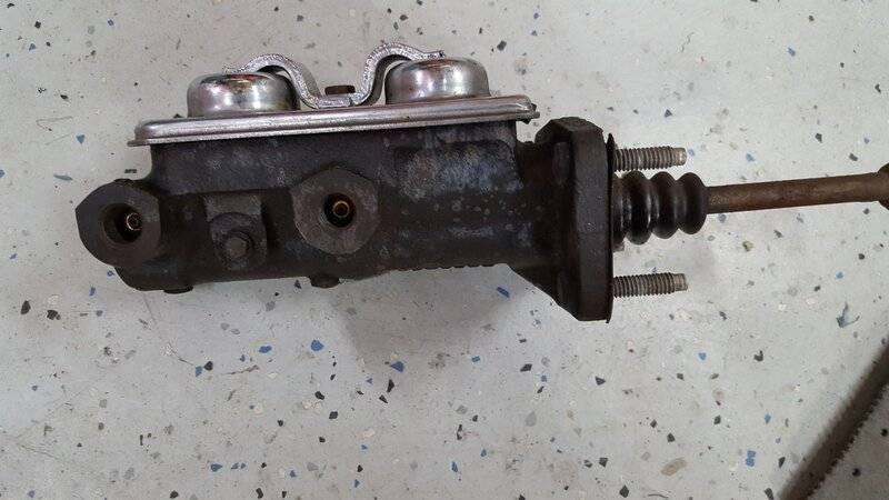

Would you happen to have a pic of your original m/c?
68 Coronet R/T original M/C
67 GTX original M/C
67 Hemi GTX M/C
All 11" drum brakes. I'm not 100% sure the 68 R/T is original, but they work great.
I'm thinking they're all the same bore - and Fred has the same lid type as your '68 - but I think the
other two are indicative of what he should have had originally?
