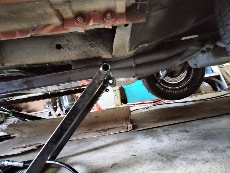

Same damn one I have! I gotta be doin sum-ting wong here. Where exactly do you put the lift points? Maybe Ill try it on the Dart instead of the GTXer. Perhaps it will reach then.
I think mine is shorter than a Dart, 108 WB. I'm as far out as I can go with the blocks.

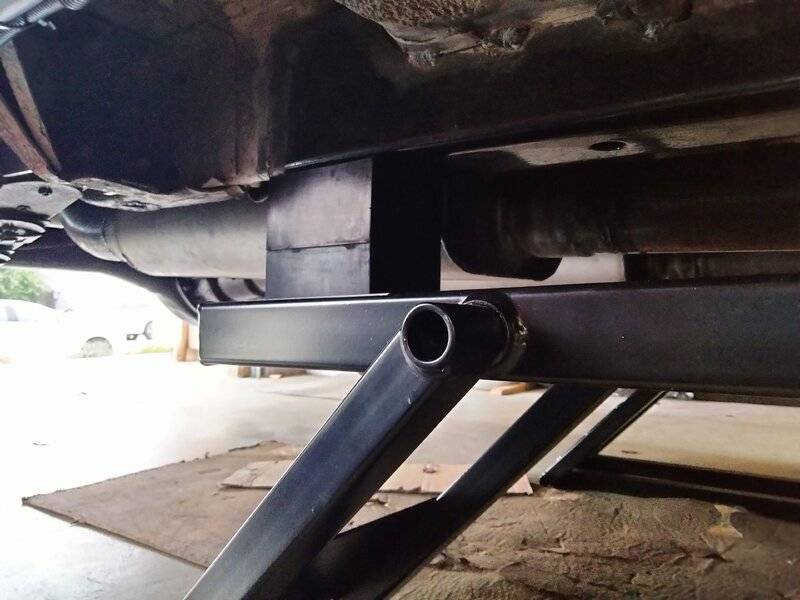

rear.....

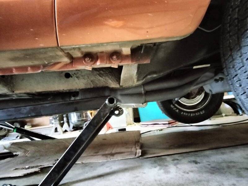

front.......

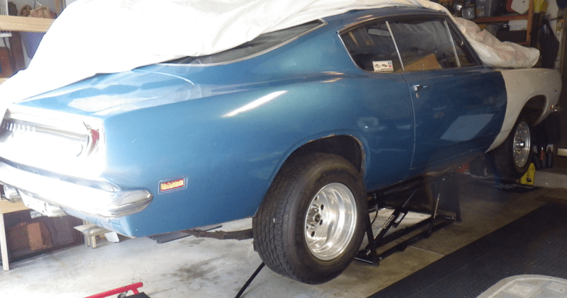

I took them down but I'll set it up again and take closer pics.

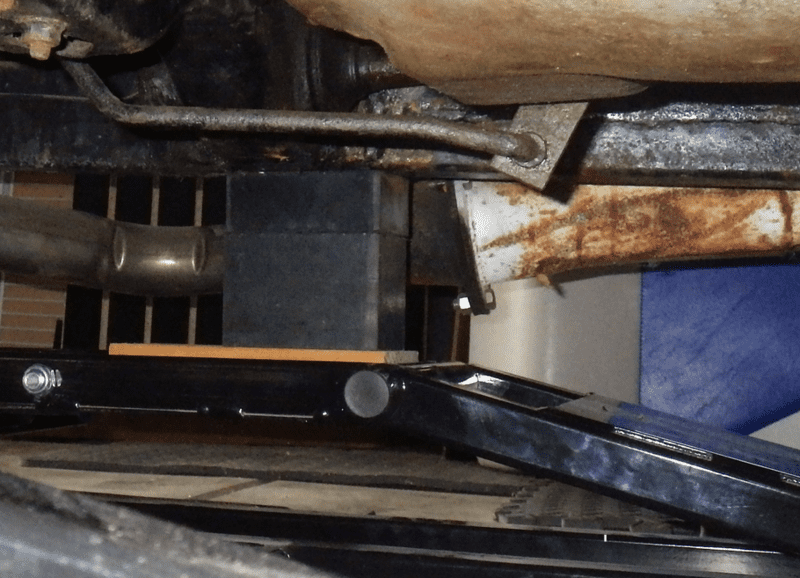

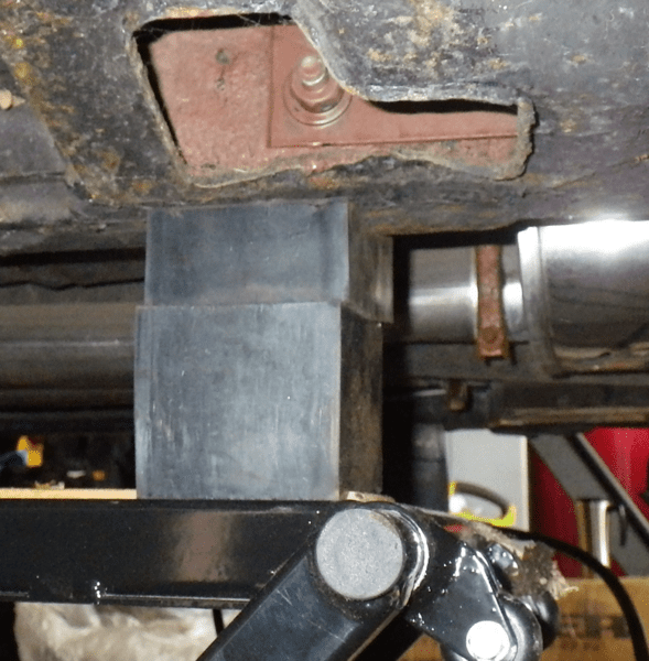

Close up pics of the lift points. With the subframe connectors I'm able to move the rear lift point forward about 2 - 3", maybe that's the difference. Also the battery is in the trunk. I pushed down on the front bumper and lifted on the back bumper and the car is steady.
