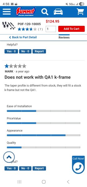

Ok im rebuilding my lower control on my 68 charger. I was going to buy one of those Proforged Control Arm Shaft 120-10005. I read one of the reviews on jegs that it doesn't fit a qa1 k member. I was wondering has anybody else had this problem and what bushing do u recommend me using rebuilding my lower control??
depends on the QA1 k-member, but the 52315 is supposed to take stock LCA. Easy button is call QA1... they're crazy helpful. Nevertheless, Proforged fits stock, it - technically - should fit the 52315 QA1 k mamber
This review got me a Lil skeptical
