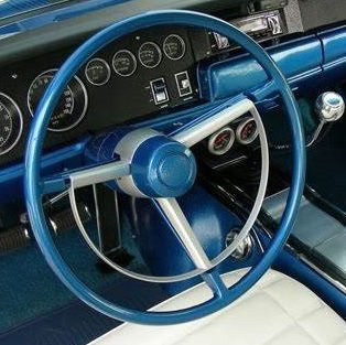

Looks just like this one, only black:

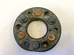

The wire looked fine, didn't see much of anything really - EXCEPT for a telltale blue discoloration hiding in the back inside
corner of one of the spokes of the horn ring.
When I looked at the corresponding spot on the switch itself, yep - there it was. That rascal was jumping an air gap!
Why? No idea.
Pressing onwards nonetheless, a feverish (it's hotter 'n' humid-er 'n' hades here) cleaning of all components commenced,
utilizing WD-40 inside the switch "sandwich" and fine grit sandpaper on all the bits that are supposed to be shiny...
and it wasn't very pretty when I started:
No matter, those rascals got silvery in short order; the copper contact ring on the butt of the wheel got shined up as well,
even though a good portion of the copper/brass layer is long gone from it, too.
Heck, I even flipped the switch over and made that steel facing all shiny again as well, even though I don't think that
matters to the operation of the thing?
