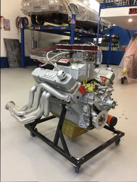

Booked for the dyno with the 505 and wondering what fuel other members have found that works best with 12.76 CR. Ive heard that Renegade Pro 110+ works well. My dyno guy says that whatever fuel that I use on the dyno should be the fuel that I stick with. Suggestions appreciated.
505RB. 12.76CR.

Earlier in the thread Superstock mentioned that he has a very similar engine with the same intake and carb set up. My engine is on the dyno today and we're going to get at it on Monday morning.

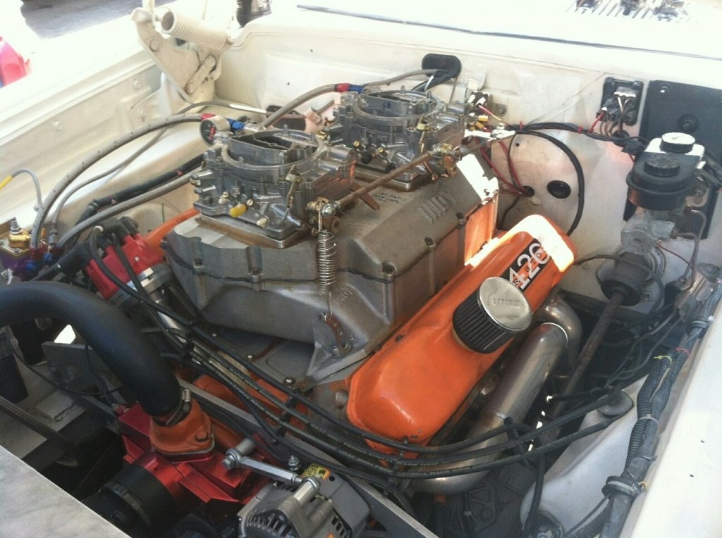

Here's my engine which is almost identicl to yours. Made 678 hp with a oe max wedge crossram and ran 10.31 then switched to the 440-25 indy crossram and with same carter 750's went 10.04 consistently in 1400 DA, went to Atco and ran 9.96 at 450DA
