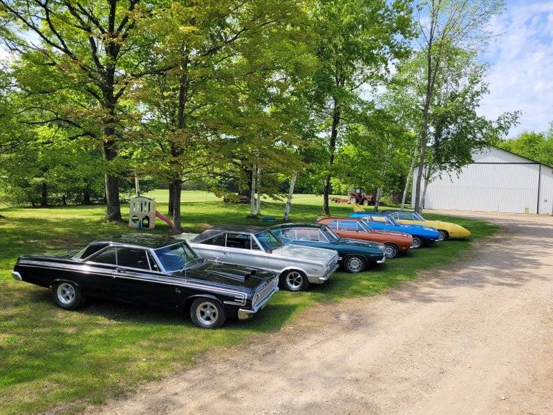

100LL has about 5 times the lead in it than 70's premium had in it. Mixing it 33/67 puts you nicely in the ball park. All 6 of my cars run great on the mix. The Hemi in the HP2 included.
