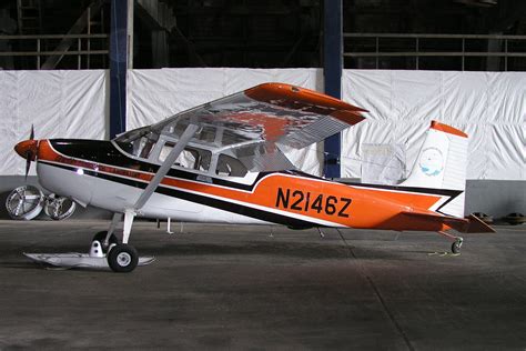

Thanks! Can you explain what the N means. Could I use a registration from a plane on the field or have on from some plane on a different field.
Most private aircraft registration numbers start with an "N". The credit card machine likely won't know if you make a number up.
