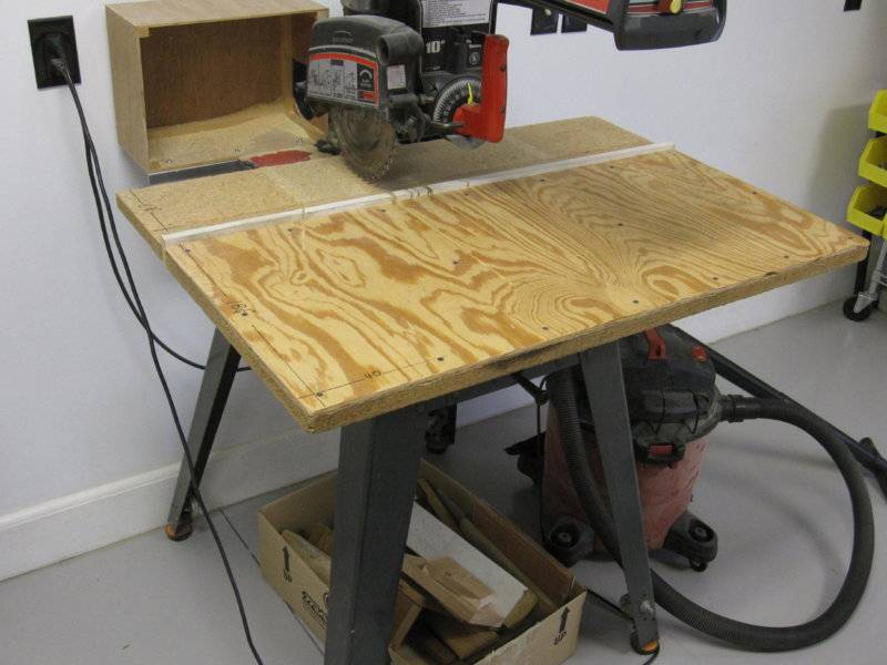

I have one too. It's a great machine. I did have to replace the carriage bearings after I purchased it. I bought a 6" Craftsman jointer from the same fella. My table is 1" particle board (OEM) and is in two pieces that sandwich the fence. Do you want some photos and dimensions?
Mike
Thanks - that would be great! Could PM if you prefer. Well come to read that the recall was due to it not coming with a lower blade guard. Ironic as part of what I used to do was helping biz's with osha compliance. I'd seldom find radial saws with a lower guard or they were beat up, bent, binding, actually making the saw more dangerous to use. Some guards would bind where you couldn't return the saw to its home position without lifting lower guard up over the fence! How safe it this? I often thought the guard was more decoration than useful; but had to have one or face a violation. If you had a finger or hand in the path, the guard wouldn't prevent injury. I have other saws; but for some work, mostly slotting, this saw works great for that...why I wanted to finally get one.

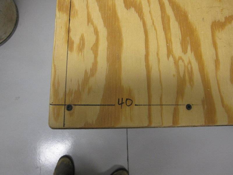

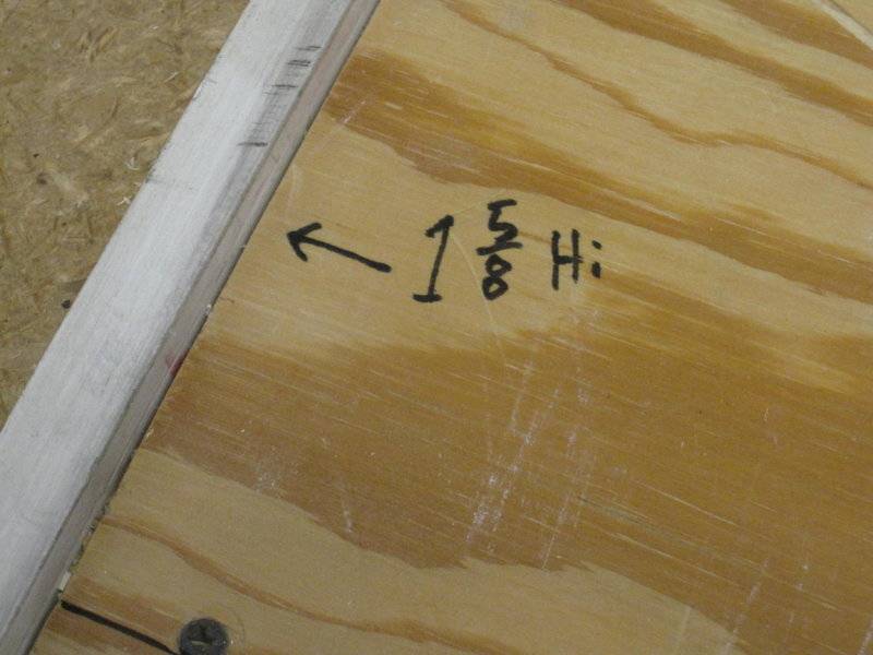

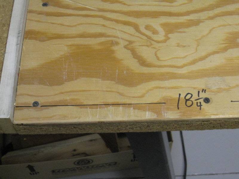

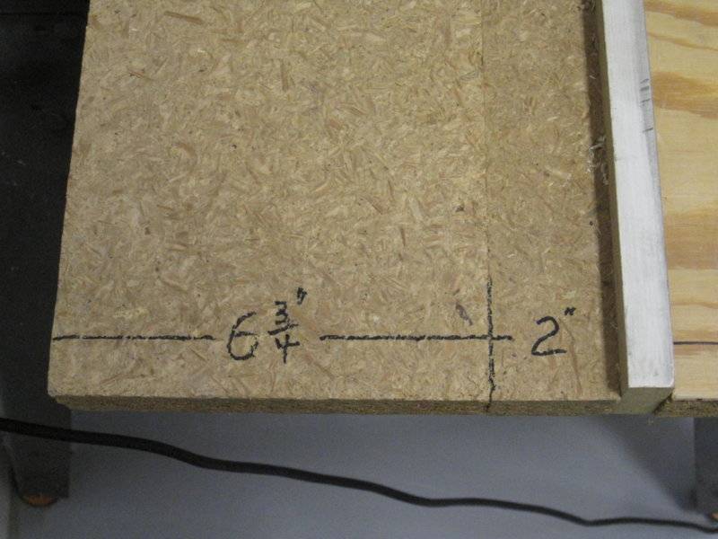

Ron,
Here are some photos with dimensions I drew on the saw table. Note the sacrificial 3/8" plywood on the cutting deck.
Mike

THANKS much Mike for taking your time to send me the photos! Wow you have a nice - clean shop unlike mine! And ahh...your injury history astounds me; you must be one tough dude! I'm way behind ya...let's see, surgeries on low back, partial neck fusion, umbilical hernia, and thumb. I got a long ways to go to catch up to ya! Ron
