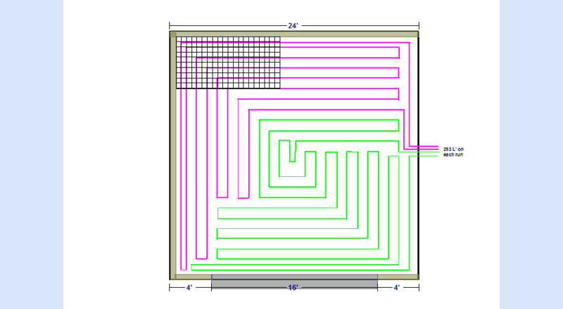

I plotted this out using 3/4" pex runs...I was able to get 2 runs with 293 linear feet in each run...

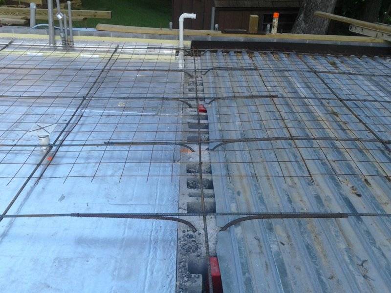

I used the 5x10 wire mesh sheets when I did my floor...according to the takeoff I had you would need 12 of them...I overlaid them on this plan and then deleted all but one back out for clarity...
I think it's set up pretty close to correct...Check it out and see how it works...
I added an extra run at 6" o/c at the garage door to cover the additional heat loss there...

Wow, your termination point is really close haha. If the pink lines came straight out instead of looping back into the green you would have nailed it. Looks pretty simple. Explain the advantage and disadvantage of 3/4" vs 1/2", I read that they prefer a little turbulence as it transfers heat better but not so much flow that it wears on Components. Basically they are saying that the water should have a pretty brisk flow which is why I thought 1/2" would possibly be better?
I had involved a heating "Consultant" early on...That's where the 3/4" came into play...I'm not qualified to call out its advantages or disadvantages... In essence I took it as it has roughly 50% more volume which would have worked out in my mind to more heat...It also has more surface area to transmit heat from...You would want to know exactly where you plan to terminate and begin your connections as that will change the tubing length some...

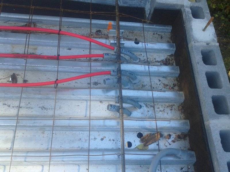

I used the pre-bent PVC 90 degree elbows to run my penetrations thru the slab in a sleeve.

I used the reflective Thermax product that was 1 1/2" thick under mine where it is slab on grade...

Clarification regarding the 90 degree pvc note. I would use conduit sweeps to bring the tubing up rather than pvc.

conduit sweeps are pvc

I think he's meaning rigid galvanized pipe (industrial conduit) for better protection? If I use PVC I'll make a channel out of steel to protect it anyways so no issue there.

Sorry for the confusion- Yes- use flexable(not metal) pvc conduit SWEEPS to stub out. This makes the 90deg transition and provides a protection sleeve for the pex.
For sheet mesh I would use 6x12-4/4 in the widest and longest sheet size you can haul. Supported on individual plastic sand supports at 2 ft. oc. each way. You do not want your PEX varying in depth and the 6x12 spacing will help with the PEX spacing. Every one in this region places the PEX 2 inches down from the top.

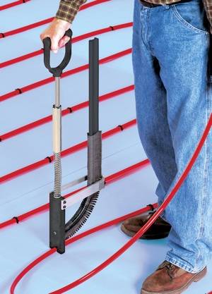

I bought one of these years ago, best investment I ever made for radiant heat.
Just lay your 2in foam, staple the lines to it. Put your mesh or rebar over it. Done. Rent or find someone that has 1. Tying pex to rebar sucks! As for the heating, 1/2" pex is just fine. That is all I have ever used. 3 250ft runs would be ideal. Just make them even in length and put the warm end of the runs on the perimeter. PVC conduit 90s work great for terminating thru the concrete.

Looks like a handy tool but also looks like a bad idea as far as Pex placement? By placing the lines on the foam there will be limited surface contact with the concrete, I would think putting it in the center or closer to the surface would be ideal. I'm a glutton for punishment so fastening it down to wire won't bother me.
