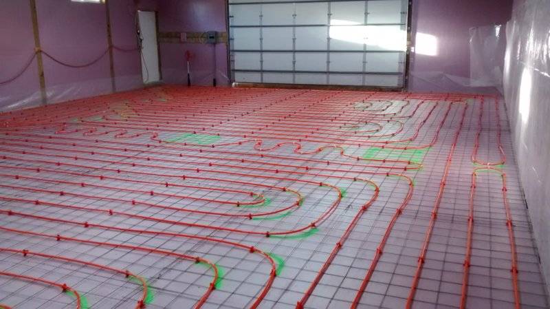

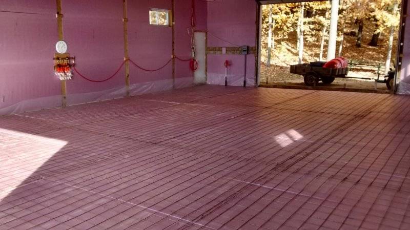

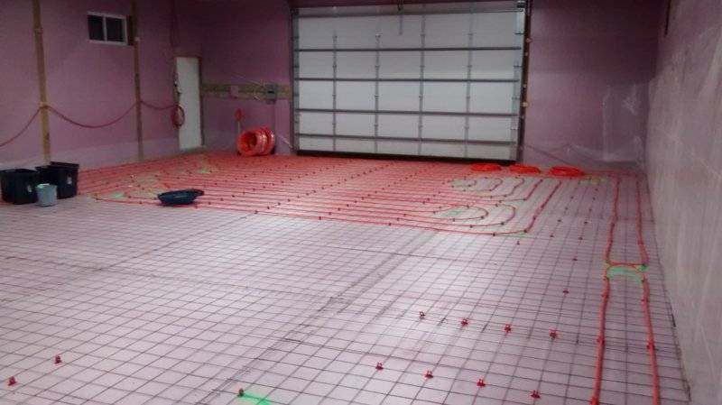

FWIW, here’s mine. I did it myself. !/2” pex non oxygen barrier (oxygen barrier or not, depends on boiler type/construction/material) clipped to 6”x6” mesh, on 12” centers, with each loop about 200’. Works perfect. It sits on 2” foam with plastic sheeting as a moisture barrier under that. The 5” slab has no outside contact except at the over head doors. Even with the -30 we had this last winter this system worked great. The 6x6 mesh makes it a lot easier to lay out the pex and adds strength to the concrete.
