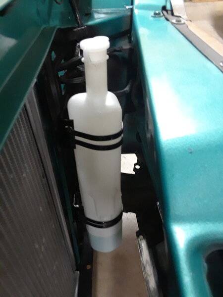

I'm running a 48 oz water bottle from walmart in my 73.
It doesn't look totally out of place.
Note- I found 32 oz was not enough to hold the volume of water than went back and forth from the radiator.

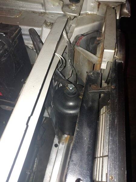

I purchased a " hot rod" octagonal or hexagonal one from Summit or Jegs appx 15 years ago.. Small enough I installed it between the grill and the radiator. Can't even tell its there.... Solved all of my problems with overheating at cruises..

Once I got the capacity right I went from adding water every other trip to only adding it about every 15 trips or less.
My is like mentioned above between grille and core support jegs brand tank
