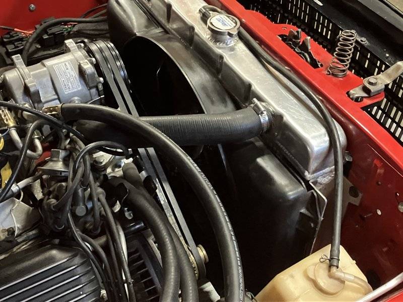

I'll probably go that route if I buy a new radiator.I have the ACC 26" radiator posted on page one. Fit is great. Only modification was enlarging the fan shroud holes to allow the use of sheetmetal nuts. Cools well with a 195 thermostat.
