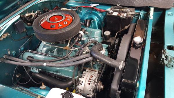

ECP for sure. I'm running their 26" with a factory style shroud and 7 blade fan... absolutely zero regrets, a little massaging to get it to fit to my liking but was worth it in the end .... and I do plan on running a/c in the near future with that exact setup ... I painted mine with Eastwood radiator paint

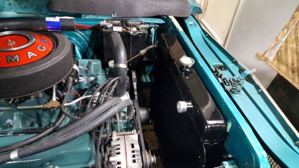

I used the griffin exact fit radiator. I made some brackets to adapt the 26" to a 22" opening. I also put classic air on. Factory shroud fit fairly good. I have pictures on my thread. 69 gtx. I made extra brackets if your interested. Derwud has a pair of them on his 70 if you have any questions let me or him know.
