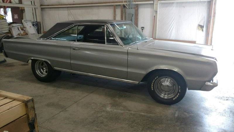

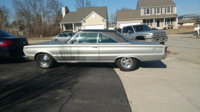

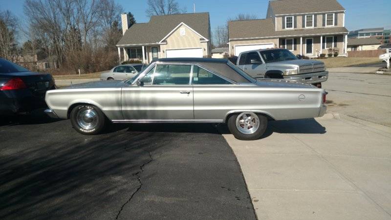

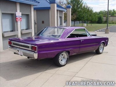

How is this configuration attained? This is the stance I’d like for myself but I’m not sure how to go about it. My car is so much lower in the rear, in fact almost half my tire is below the fender edge at the wheel opening. How does one get that *** up nice and high like that???
In the photo you posted, I see shackles added to that cars rear leaves. But they don't look long enough to get the 'total height' achieved by that car. I would guess there are air shocks under it as well.
You can temporarily get there with air shocks...drive it a bit to see how you like it (I find if I go too high, I feel like the seat is trying to dump me forward).
NOTE: Ride will be stiff with that much air.
By doing this as a 'test' you can play with the height before spending money on re-arching springs...to what you 'think' you want...only to find you don't like the results.
I like the fender lip on my '66 even with top of the wheel. A good spring shop can tell you the amount to add. If traction is a consideration, custom leaf combination is needed. The Espo springs that came on my '66 were a great ride height & provided good traction. The good spring shop can make your stock springs what you want. If the springs aren't shot.
Omg your paint is soooo sick! Love that color! And that is the stance I’m looking for, are those super stock springs??
Far as I can tell the SS springs varied quite a bit over the years in the arch/ height. Leaf package seemed to change.
The higher the rear end, the worse the handling will become and traction also goes away. For those that are worried about the rear shock mount, put a bottle jack on a scale at the rear bumper and see how much force is applied. It won't be real accurate because of where the jack is placed but it'll give you some kind of an idea how much will be applied at 1", 2" and so forth. It might surprise you and using air shocks for a 2" rise shouldn't put undo stress on the upper shock mount. I find it kinda odd that I've never had any issues with using air shocks and have used them on many cars. A 67 Dart was used as truck for years and even hauled a complete 383 to the other side of Houston once. Hauled lots of junk in that trunk :D. The shocks were aired up to the max just to level the car out lol.
