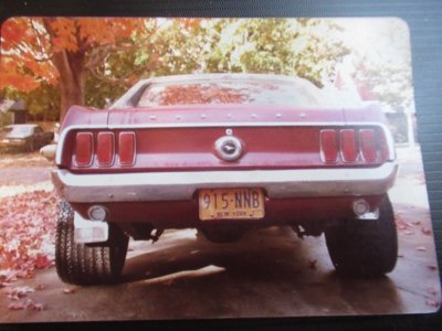

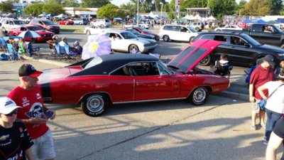

I like a slight rake. Not the all jacked up look. Slightly taller & wider tires in the rear than the fronts. Guess I like them low. (But not lowered). All stock factory suspension on my Charger. Caltracs with -1" split mono's in the rear on my Challenger since it is a 30" tall tire.

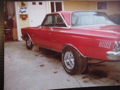

My look back in the 70's. Fill up the air shocks and crank up the torsion bars. In 10 min. you could have a different look. It drove the GM and Ford guys nuts. :rofl:
