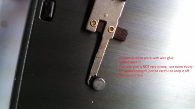

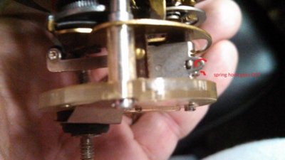

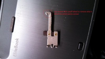

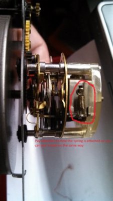

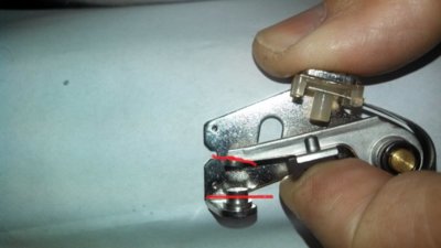

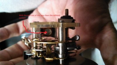

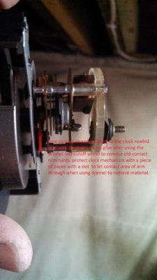

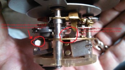

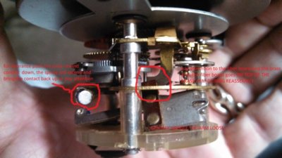

If you have an original rally dash clock that won't go "thunk" when power is applied I may have your fix. I just replaced points in a couple of these and they are working like new. It takes a little time, a set of points, some conductive glue (I used Anders Products Wire Glue), epoxy and a Dremel to make it easier. Pop the cover plate off the back 1 tab 2 crimps on the sides, remove spring (picture 4), with the spring off remove the solenoid contact arm (picture 6) , clean the solenoid contact (picture 7), prep arm for new points contact (picture 8), cut contacts off of donor set of points and glue in place with CONDUCTIVE GLUE and EPOXY (pictures 12-13). Reinstall the solenoid arm and reinstall the spring (pictures 14-15). Hook up to 12 volts and watch your clock wind and run, I have done 2 of them and they have been running for over a week. Just so you know the reset will be less than 2 minutes, I think the increased thickness of the points causes that, mine both reset at about a 1 minute 35-40 seconds. Hit the clock part with some TV tuner cleaner and lube while you have it apart. Sorry about some of the spelling.
