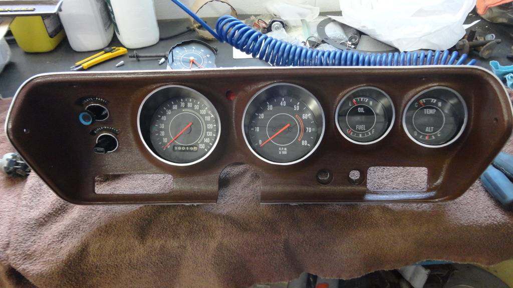

Here is mine.

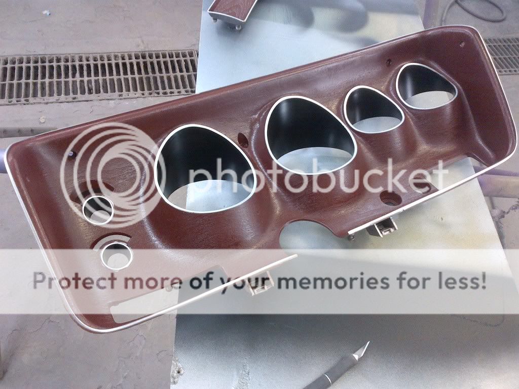

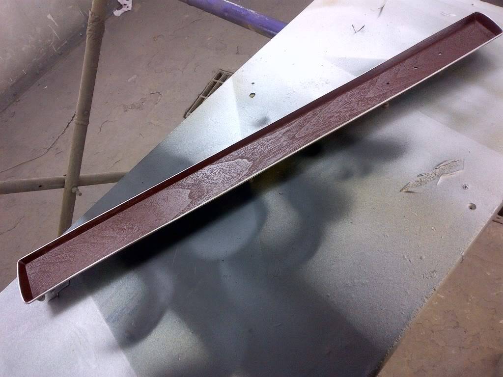

My bodyman painted it, so I cannot really tell you what he did? I love how it turned out though.
Here is mine, I wanted it darker then just the tan, so I took flat black paint and thinned it just as you would to use it with a paint gun, I then took a rag dipped in it and gently whipped it over it until i got it the shade i was happy with. The small shine to it is nothing more then Armor-All to give it (to me) just a little shine... More you rub, darker it would get.
Here is what mine looked like sitting in the car to see what it would look like with the dark against the white faced over lays i put in, i had the flash on so the new lights didn't show up in this one. I do have a picture of the P-side piece if your doing that to match, if you want to see it.. This picture really seems a tad darker then it really looks like, at least a daytime picture with it installed.

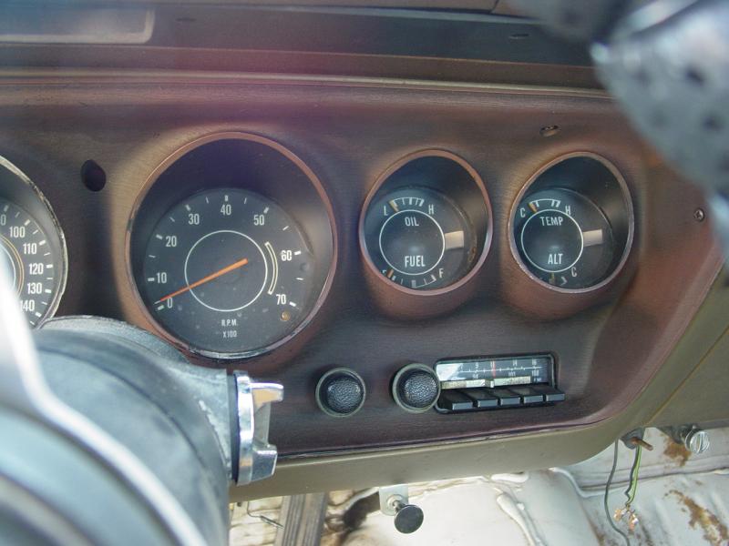

71ChallengerSE.. Thanks for starting this, im gaining a little in-site into some things, like our clusters the gauges are a little different in the Chargers, same year? or are they the same and the one i seen somewhere was a DIY one.. I think some came with tachs where some had clocks to, im just guessing or asking maybe, ive seen both and different looking gauges in these though.. I hope some more post as i believe it was Rev that painted his black, i seen one that looked real good a Argent silver to.

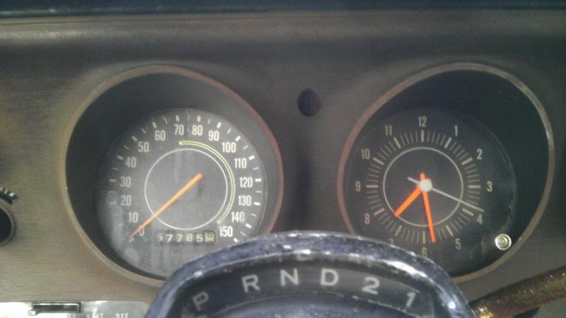

I have seen many different ones 120 and 150 spedos, clocks, tachs and split oil/fuel. Just depends on the car and the options. My RR was coded for a tach and my Satellite was not and came with a clock but other than that they are the same both with 150 spedos.

Your quicker then me typing lol, Ok i have seen them like that, But with mine that second one is fuel tank indicator and oil pressure...
I've amassed all sorts of set ups in an effort to come up with a 150 speedo and tach.
