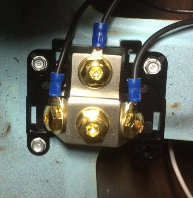

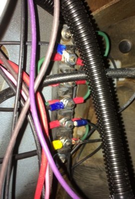

I used the terminal block from the core support originally used for headlight wiring in my '55 Plymouth to make a ground distribution block. I've run a 10 ga. wire from the battery negative terminal to the block. Now I know I have a good ground. I ran a wire from this ground distribution block over to the passenger side kick panel area and installed a ground distribution block I grabbed off of Ebay. It's nice to have a location to where I know there's a good ground.
