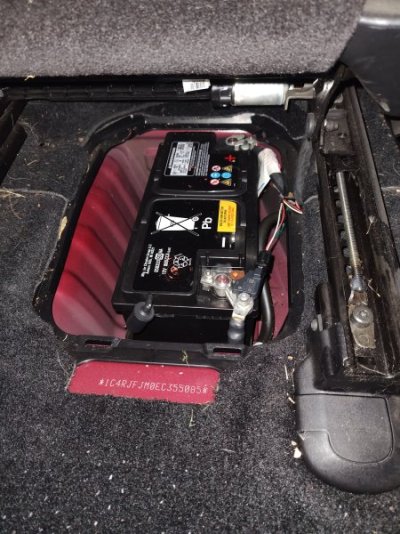

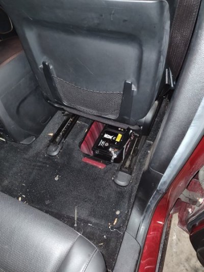

Gotta change the battery in my grand cherokee tonight :( have to remove a seat to do it.. and pray it starts after.... ugh
Just did it on my 2014. Don't have to remove the seat. Move it full forward, and up, and the battery comes out via the back seat foot well.
yeah.. was wondering if it would move forward enough.. i have to do the aux battery also to get out the main...

No auto start-stop junk on mine, so only one battery...but being a diesel, it's a BIG battery. And like you, it was a cold snap and my remote start didn't work one morning. Put a charger on it and it would only go to 3/4...so I changed it before it stranded me.
I had the charger on the under hood posts while I changed it (kept the + terminal away from ground), and I didn't even have to reset my radio stations. Fired right up when done.
All you need is a 10mm socket, and an extension to get the nuts off the retainer at the base. I used a magnet on a stick to pull the nuts and retainer (hold down) out. The terminals are a goofy wedge setup, you loosen a vertical nut and it loosens the terminal clamp. You don't have to mess with the 13mm cable nuts.
