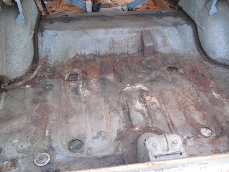

Confirm that the trunk of these cars got grey spatter paint and where not painted body color like later B-bodies?

Factory trunk on mine had the gray spatter paint.

I have a 64 440 and a 64 polara. They both have the grey splatter in the trunk, and both the radiator supports are painted the color of the car
