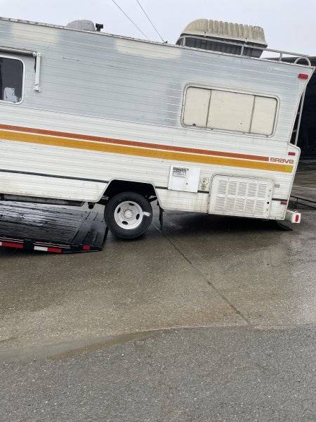

I bought it sight unseen, mainly because it was supposed to have a running 440 and had a Gear Vendors O.D. on a 727 in it. I want to run the GV in my Coronet if it will work, so I enlisted the help of a good guy who works at the local steel mill and is a full-time scrapper with a really big trailer. When we got there the old guy who was selling it explained that he had to do some custom work to get it to run, some of which was wiring up a short cut ignition and fuel pump system which included an open fuel tank in the RV. Decided to let my scrapper friend load it. First attempt was the opposite of being high centered...
Kind of hard to see but the back wheels are off the ground. Second, high speed attempt was even worse, with about 6 inches of air under the tires. The old guy saved us with a forklift and we got it home with no problems. Had to cut the rear bumper off to get it off the trailer and I still needed to use the Kubota's bucket to get the weight off the rear for a bit. My wife was pretty good natured about the eyesore, considering that I may have told her I was buying some parts, which apparently isn't the same as saying you are buying a motorhome.

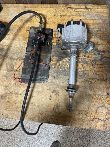

Since the O.D. was what I was after for the purchase price, everything else is an added bonus in my weird way of thinking. Like the Perko switch, which I will most likely use on a pontoon boat project I have been messing with. One of the treasures I agreed to give back to the seller is this interesting distributor that he made to get the RV to run...
a better look...
Looking at his work, I am amazed that the thing really functioned. Heard it and saw it in action.

Just for future info here...When getting any vehicle up on a trailer and it appears that it will contact the ground at any point, get some long boards such as 8x8x10 footers and build approach shoring on the ramp portion and the ground. This will lift it without having to use any kind of lift vehicle to help get it up and onto the trailer. Ground clearance is a bitch I know but when one has spent all my years as a Loadmaster loading heavy vehicles and trailers onto large cargo aircraft, this was our standard op. Same can be used for a similar situation as yours. Just sharing is all!!! And by the way...Nice score on the parts from that hulk. Hopefully you can use them and won't give you any real issues in marrying them up to your other ride...cr8crshr/Bill:thumbsup::thumbsup::thumbsup: :usflag: :usflag: :usflag:

Good advice. I usually plan ahead but I didn't take into account the tremendous rear overhang on these beasts. Will use boards to get it back on the trailer when it goes bye bye.
