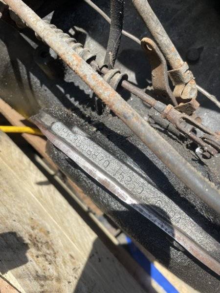

Laying on the ground the trans seems like it is a mile long.Where do you see a shorty 727? That's the standard 18.5" tail shaft....
Nowhere?!...I didn't even really look at the pics just assumed since many of the RVs had the short ones. Oops!Where do you see a shorty 727? That's the standard 18.5" tail shaft....

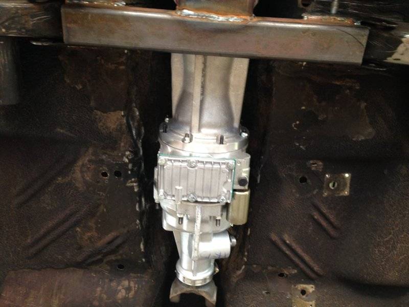

I may do the exchange thing since I know nothing about this unit's condition.If you decide to go with one of the shorter adaptors, there are 2, you can exchange your existing one with GV to get what you want. They do charge for it but it's not the full price. Also they can give the od unit an inspection. They have those available as a reman exchange. This is what I did for mine. I exchanged the extension unit, came off of a C6 Ford, for the mid length 727 unit and had them inspect my od unit. Didn't want to get everything together just to find out the od was toast. It was.
Dodge 3-Speed Auto - GearvendorsI was in the garage earlier to work on the car and took a moment to measure my case adaptor. Its 15.5" long.
Good question. I guess just the unknown history. I never saw one of these in person before so I am at a loss as far as how to check it out as far as condition. I would hate to install it to find out it doesn't work. I suppose I could though.Why do you want to exchange it? Looks like a bolt in deal to me....
