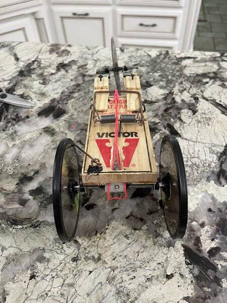

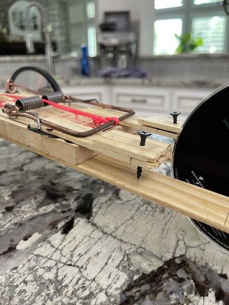

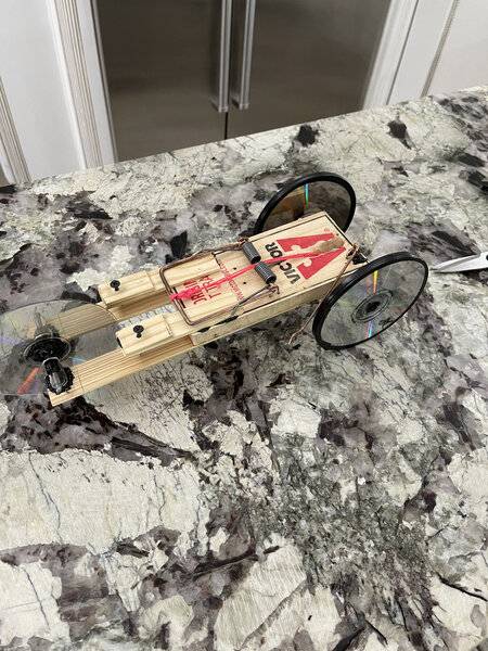

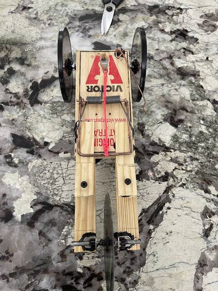

So…..my son’s physics class tasked him to make a rat trap racer
…..I may have helped a little
(hehe) adjusting front torsion steering was a nice add on
F167B769-5989-4AB1-827F-253E7F84B24F.jpeg 2FFFF9CC-A83A-4D11-A554-9B2D8F1ABF67.jpeg D25D13D7-7D86-4870-8149-E69879D62D6E.jpeg BCF4EB81-3BAC-45F3-9549-6C72686A9E6B.jpeg
Are those wheels CDs?
We used CD's on our boys project and while it didn't win, it went the farthest by a long ways because of the "drive ratio" and almost zero rolling resistance from those CD wheels.
I decided to use 5 CDs on each side, and a shorter throw from the drive axle, now we just need to get the grip just right.
