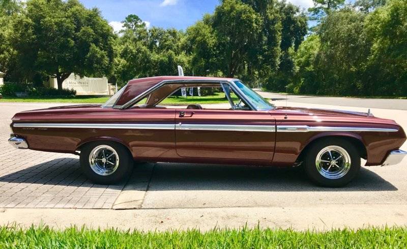

Finishing up and working out the bugs....have a few rattles and clunks (from under the car) that need to be chased down...really noticeable on a rougher road. Any similar experiences and solutions... comments would be appreciated. Alignment scheduled for next week.

Car looks great!
As for rattles and clunks, grab the exhaust and shake it to see if it's making contact with anything.
Also, make sure all suspension parts are torqued. Strut rods tight on lower control arm, shock bolts tight, etc.

Who cares about the rattles/clunks.....With a flipping car that looks like that!
Beautiful ride.....

That's a Sweet Looking '64 love the color and wheel combo :thumbsup:
