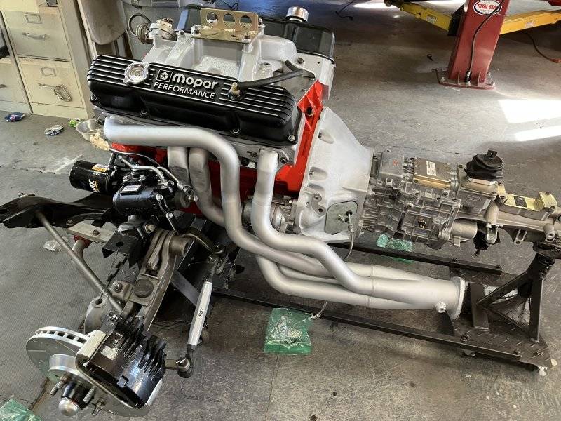

I have removed many engines while leaving the transmission in place but they have always been automatics. Last year when I pulled my 440-493 for a refresh, I pulled the engine, trans and K member all at once. This was partly because I have a 5 speed manual and I wasn't confident in mating the engine to the transmission without great difficulty.
