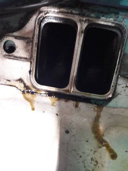

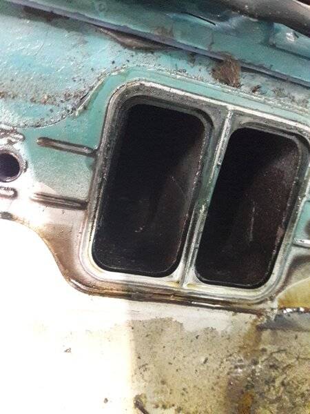

Anyhow I have plug fouling on the right bank and it looks like it is sucking oil.
