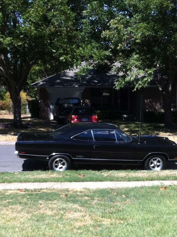

Good looking car!!!

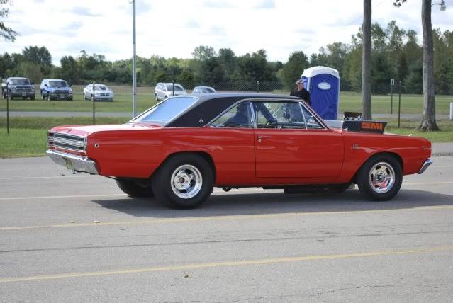

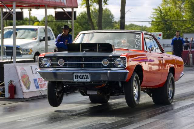

thanks! so yes you the rear end will rise for the caltracs to work correctly. as you can see my car lifts a pretty good amount in the rear.
this is how it normally sits.
