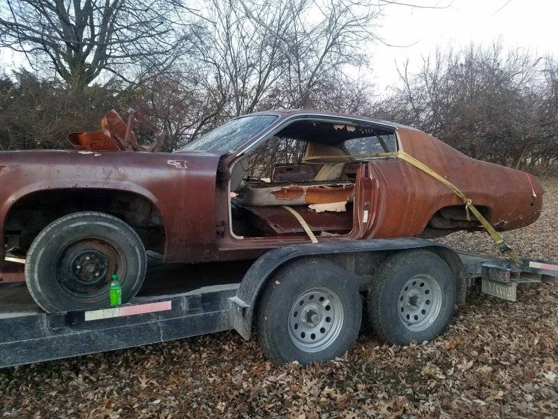

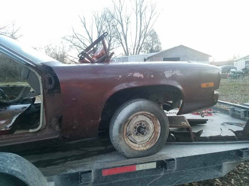

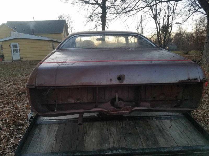

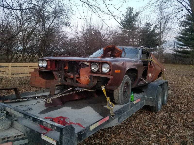

Late last year I bought a 1973 Plymouth Road Runner " G " code car. Now as sketchy as the condition of the car is in, and it's rough. I still can't come to terms of cutting it up and ending it. Thus the revelation. I really do not to go Pro-Touring. However I have been thinking about using the rear end set up out of 1 of the late model chargers/SRT's . But then! Then I got the idea why not take the body off a late model car and put the body of the '73 on it? Has anyone done this? Is too much for the purists? Chime in and leave your thoughts. Be kind though. Nothings happened yet.

A '73 Road Runner is as desirable as a '73 Thunderbird. Strip and sell what you can and junk the rest. Cut your losses and move on to something better.
People are putting 69 Charger bodies on Ford Crown Victorias. The track of the Crown Vic is a bit wide though so they look a bit off unless you narrow the rear end and put shorter front control arms on it. If one has been sitting in a field and the bottom is rotted away, then I get it...install new quarters, fenders and doors and drop in on a new chassis. Running Chargers are so expensive and sought after that you may actually get your money back when you sell it to someone who's desperate for a cheap General Lee. A '73 Roadrunner is a nice car, but is it worth the time and effort?...only you can decide that. Btw when I say "drop" it on a new chassis, I mean meticulously cut away both cars until it looks like you can put the pieces together...unibody body swaps are more difficult than dropping a body on a full frame chassis.
