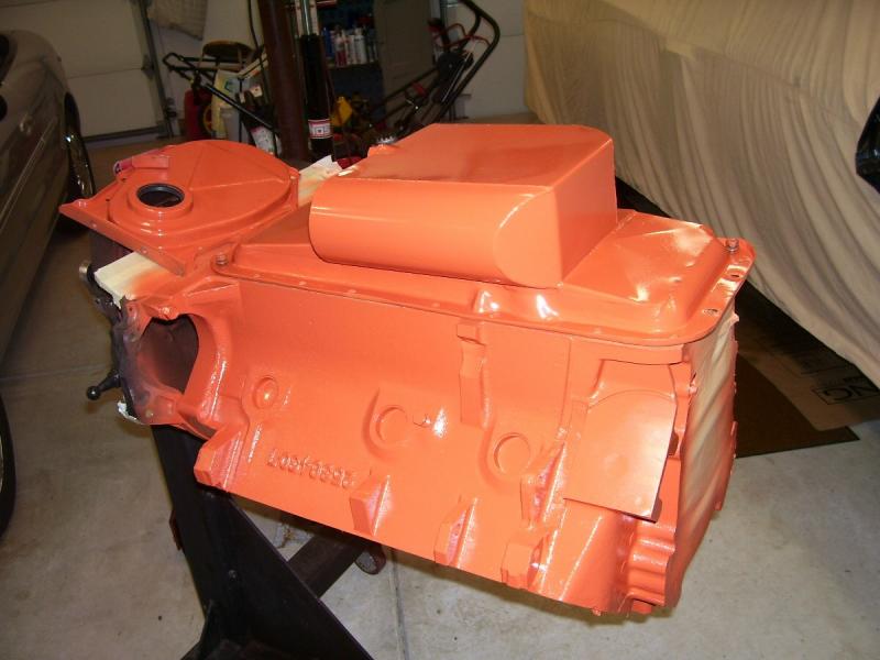

i made this one. low profile "track" type pan. complicated to make but there aren't many affordable alternatives.
