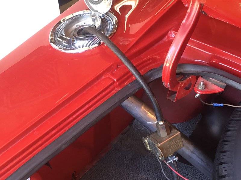

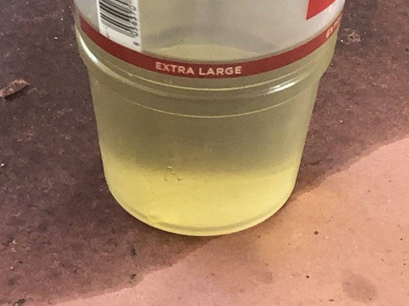

While on the drive, I stopped to get some gas. I filled up at a lesser known station and soon thereafter, the car started running weird. It detonated a bit, was down on power and knocked even as I released the clutch to move from a start. I wondered if the gas was to blame so I took an electric fuel pump and sucked it all out.
The gas looked okay though.

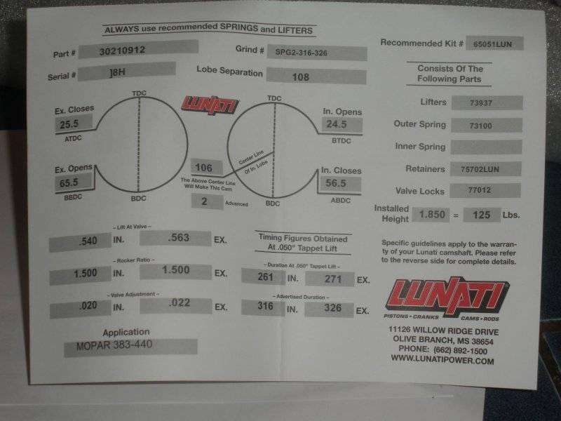

I thought that I did everything right then. Since then I have switched to solid cams. I had a Lunati for awhile but swapped in this 528 about 8 years ago. Both of these cams had Howards flat tappet lifters with the direct oiling hole. I thought that this provided an extra layer of protection.
I have been using Redline 10w30 with extra zddp. I add 1/2 a bottle of Comp Cams break in supplement at each oil change. Why did this cam go bad?

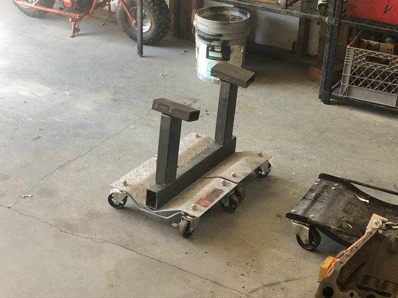

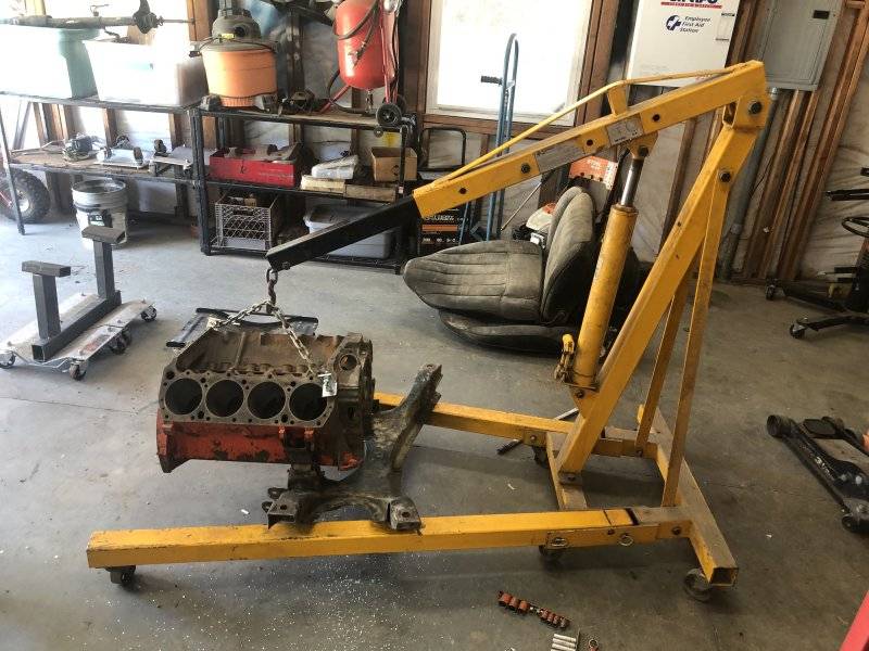

Now that I am faced with pulling the engine, I want to do a remove and reinstall from underneath. To do this, I needed to make some sort of cart to support everything. I started a thread on that too:
https://www.forbbodiesonly.com/mopa...nstall-from-underneath.246546/#post-912250641

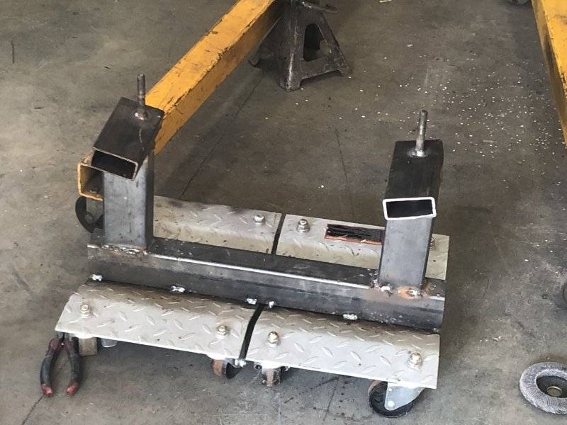

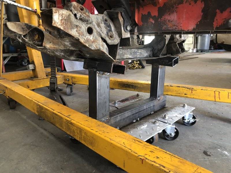

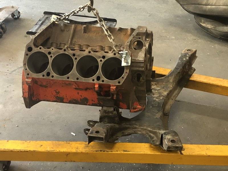

There were some great ideas posted there. I took some cues and started making my own. First up, I took a spare K member and a bare 440 block.
Then I took a couple of steel dollies and welded some 2 x 3 channel....
I noticed that the bottom of the K member had holes in it, not sure of their purpose originally. I decided to use them as guides to hold the engine to the stand. I welded 2 old 1/2" bolts to the "pads" so the K member cannot slide off.
It is some bonehead engineering but I think that it will work.
