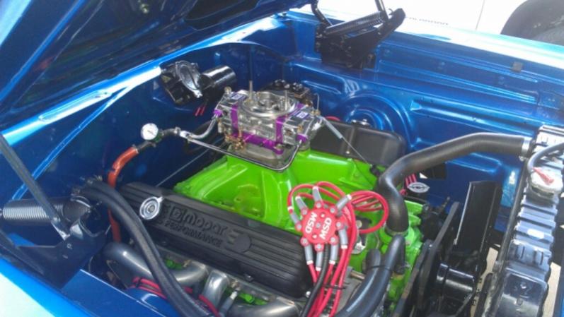

I guess its that time of year because mine was doing the same thing, so I upgraded to full MSD electronics, ran well but still had that spot of break up. To day I junked the edel for a preform 850 and its awesome. Between the msd and carb well worth the money even though for everything it was about $1300. 578.jpg
