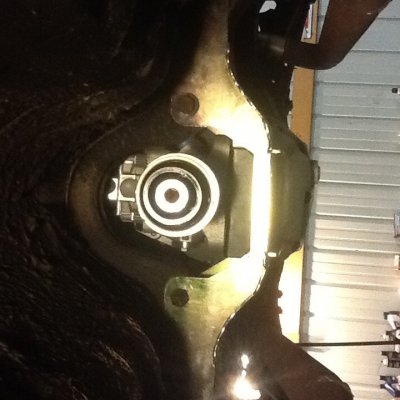

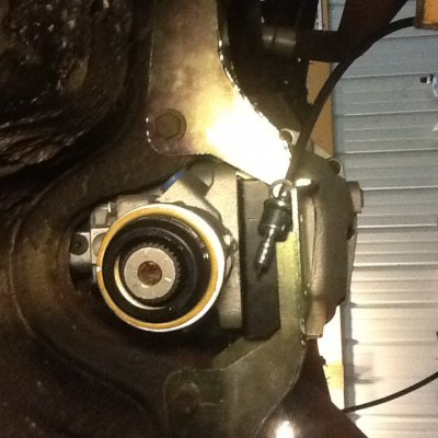

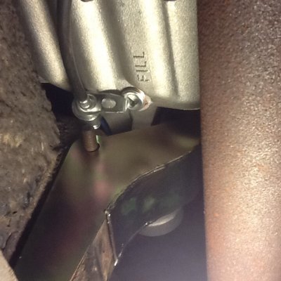

The Ugly-:angryfire: Well,Im not sure where to start! The first thing is WTF is up with speedometer cable! That's not going to happen. No way to clear support to get that cable hooked up. I ran a new cable that came with kit,just can't use it. But wait there is more! As I scratch my head and try not to lose it,I notice the crossmember and mount don't line up.The mount is not right or the crossmember is wrong WTF! I have 2 mounts with the kit. One bolts to trans but not to crossmember the other Doesn't fit trans or crossmember.now Am I missing something like the right parts?:shruggy: image.jpgimage.jpgimage.jpgimage.jpgCheck out pics.
What do I have? What do I need?
:banghead: I had to just cut out the lights and give it up for one day. That sucks no speedometer unless I cut tunnel support.
I called SST they have a block off plate for speedo.
SST looked up the part number on crossmember. It's made for a 69 Bbody but for a tremec TKO 600. That explains the offset bracket on crossmember.see pic.
I recognized The rubber Mt is for a 65-70 mustang top loader,included with kit.It fits nothing on this kit.Another mount with kit fits Chevy camaro.
He said I could order another crossmember and mount.
thats more $$$ and I still need a yoke and drive shaft. I can't take measuments for drive shaft to get it made till I get Trans bolted down in rear..Looks like trans needs to go up in rear see pic to get tail shaft as high as original 4 speed tail daft was.What to Do?I need time to think on it.

I was able to make the crossmember work.I drilled holes for mount to avoid offset.I tried a couple different mounts.I tried a 96 mustang trans mount.Little to high in rear. I used Chevy mount with a 1/2 inch homemade spacer.There is no solution to speedo that I can see.I almost cut off the offset bracket on crossmember.It was not in the way so I left it.If this tranny turns out to be a P.O.S. I have option to go TKO without buying a $300 crossmember.

I will say everything on front of trans fit as it was supposed to.Its the rear of trans where things were not so perfect.I got it in place now (waiting for speedo block off).

That crossmember looks to be for a TKO or a different body and I've attached a photo of the proper B body RS crossmember. The speedo port location was a bad deal from the start and the final revision moved it to the driver's side. We do not have any of these unfortunately.

Thanks Overdrives for checking out the thread,I really appreciate the input. The crossmember in pic looks perfect.I was able to make crossmember fit but I need the correct rubber Mount between tail shaft and crossmember. Is that available?
Absolutely, give Ben a call and he can get everything set up for you.

If more parts show up today,I may try to tackle that speedo hook up. The speedo gear itself or the plug is going in the hole on tranny my friend.I got a few ideas but just have to dig in and see if I can make it work. Will post some more of it pics later today.:icon_thumright:

The adaptor for shifter and speedo gear came today from SST. Looks like I can get busy this afternoon.:toothy10:
