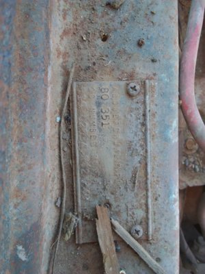

How to validate someone claiming it's a real 65' Plymouth Street Wedge car?
VIN's, fender tag, anything else?
The reason I asked is because I want to be "dead-nut" on when I go inspect. It's not that I don't trust the guy, but he's a dealer. Sometimes he exaggerates (benefit of dought) when he acquires a car he believes to be rare. At any rate, he claims to have two real 426 4sp 65' Belvedere Street Wedge cars.
I'm not in the market, but maybe someone else would. I'll let y'all know what I find out.
streetwedg said it should be stamped 80 under AB on vin tag. No sure if that applies to '64's as well.

Well, here's the skinny. The first car isn't a Street Wedge and it's a POS. However, the second one (pics) appears to be a real Street Wedge. Fender tag has 80 under AB, if it hasn't been changed. I was rushed for time but looks like the original engine. Don't know about the trans. It now has an auto. Pedals are still in the car. I don't think the steering wheel is original. Haha
Does have rusty quarters.
Anyone interested PM me for contact info.

On the fender tag, 80 under AB.
Yep, the 80 is the code that you need to look for on a '65. I've owned my 426W car for almost 40 years now. Picked it up for $1500 back when these things were just used cars. Mine is a Coronet 500 with the 426W and a four speed. Mine doesn't have a lot of options, had the console and tach, back up lights, radio with reverb and tinted windows. No PS, PB or AC. The cars pictured look horrible to me. I don't have enough time left on earth to tackle rusted out hulks like that! I can barely keep mine running and it is in much nicer shape that either of those hulks.
