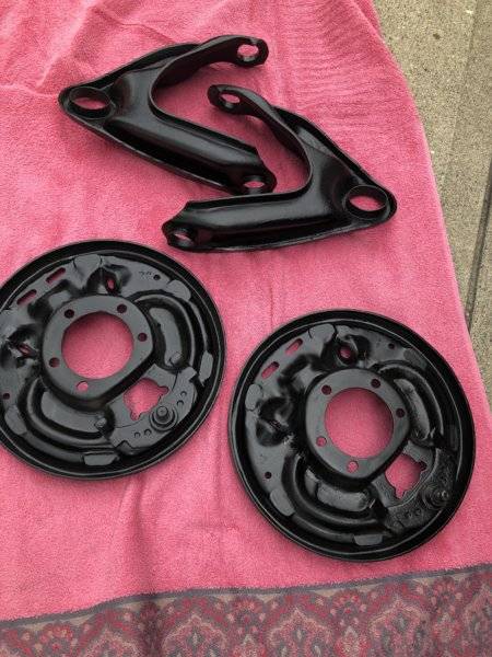

They fit. The five bolt holes on the backing plates
Are the same for Dana 60, 8.75, 8.25, 7.25
Get the spreader bars and e brake levers too
These are off one
That is good news. Now if the penny pinching pricks at the yards don't try to squeeze me for every spring and shoe....
If you can find them at the self serve yard just take the plates, spreader bars, and e-brake lever. The hardware and hold down kits are super cheap at rock auto as are the shoes and drums
