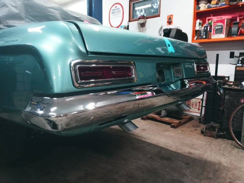

Does anyone have any idea or picture of rear bumper filler strip on a 65 Coronet? I have new strips but don't have any old holes to see how these mount?????

If you're asking about the 90* rubber corners, they screw right into the bumper, if I remember correctly. I just put my new ones on my '63 last fall...

There are Phillips head screws that go up into the body on some cars I have seen 5/16 headed screws but they could have been messed with..
They mount to the car, at least on a 64.

You both may be correct. I thought I put them on the bumper before mounting, but my mind may be wrong, again...
mine are screwed to the body. what i have is the original pieces to the car.
Not sure if a 65 Belvedere is the same, but here are pictures of the hole locations where the filler mounts. The filler just snaps in and hangs over the end.

Screwed to body. You can see them in the trunk
