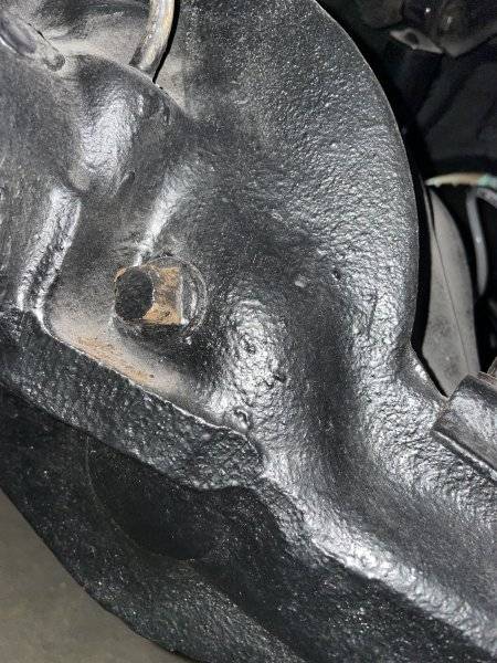

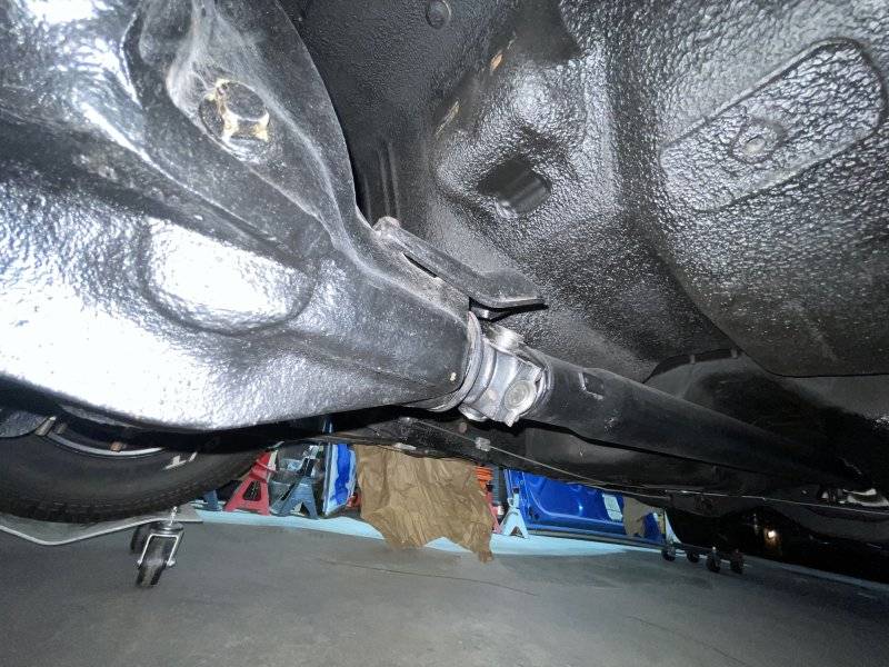

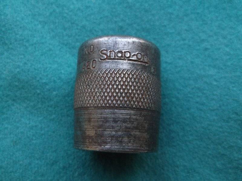

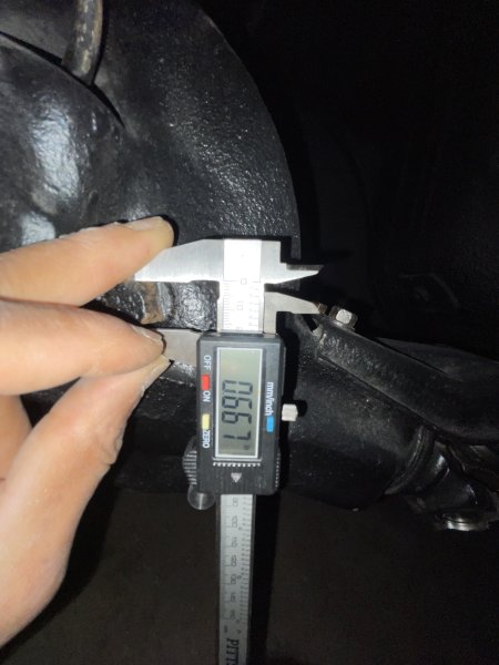

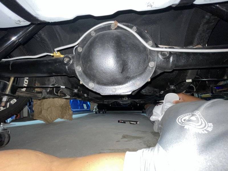

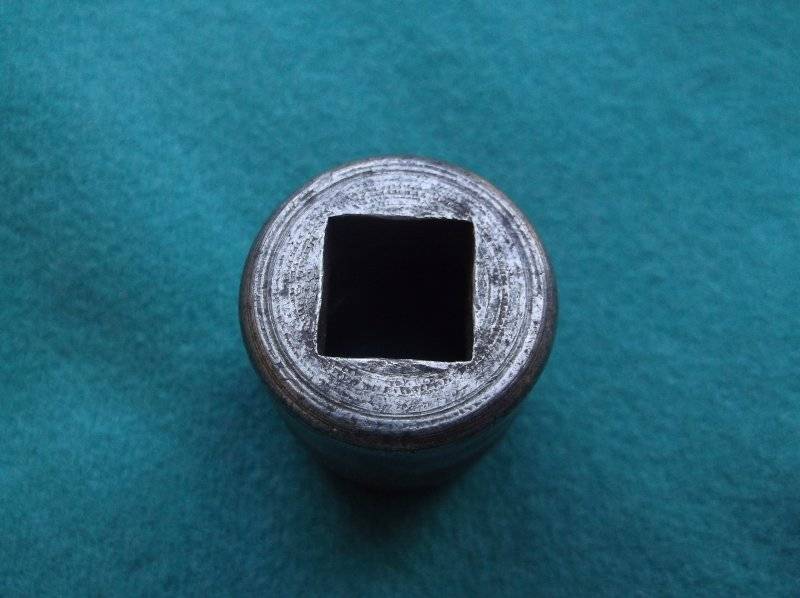

Trying to figure out the size of the rear differential drain plug on my 73’ 318 Auto charger. I believe it’s a Dana not exactly sure the size 8 1/4 maybe? I’ve tried a 3/4 square socket (to large) also tried 11/16 12 point socket almost grips but slips under tension a open ended 17 is not to large and a open ended 16 is to small. I attached some photos using a caliper it read ~.667”.
.667 is .020 under 11/16. I'd try an open end 11/16, but I wouldn't use a lot of force. It looks like somebody already rounded the corners off. Absolutely positively has to come out? Eight point socket.
I'd try a 11/16, but a 17mm might be better.
I'd also try an open end 17mm before I bought something new (17mm≈ .669).
Edit:I'd remeasure with your caliper, picture looks like you have it cocked a bit.

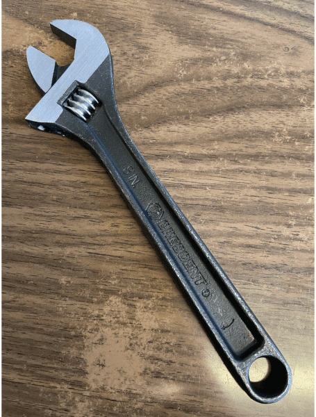

Get a quality crescent wrench that the moving jaw stays square to the top and they won't round off things.

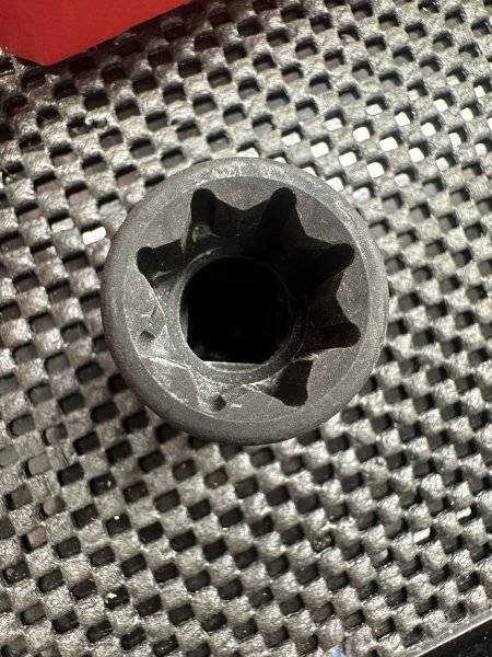

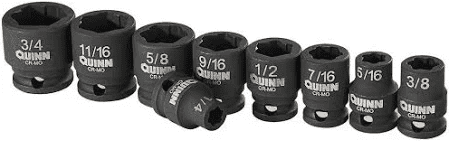

They sell 8 point sockets for these square plugs.
They are pipethread and don't need to be very tight, they won't come loose if you put 25 ft lbs on them, not as tight as you can.
You may want to heat up the case, around the plug, with a torch. After, chill down the plug as best you can. Those rounded corners are looking like the plug is near end-of-life.
You lost me on "drain plug", it's the fill plug, I would replace it
when you get it removed, being it is in the final stages of being rounded it looks to me.
Agree it looks like it's at the end of it's useful life.

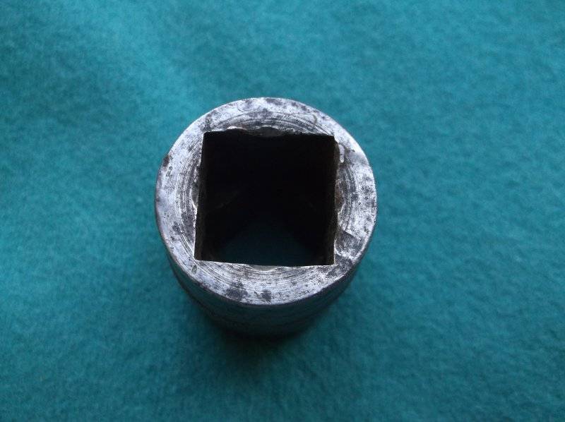

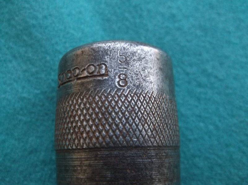

This would probably work pretty well. 1/2" drive on one end, 5/8" square on the other.
