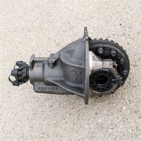

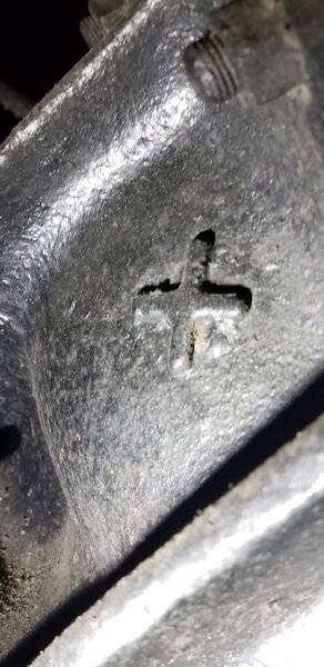

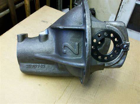

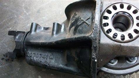

Drivers side 7 digit part number down low right behind the yoke. Also a large single digit on drivers side same place as the large fill plug on pass side.
Look for a X, 2, or 9. The Yukon case will have a large Y there. It could also be a late 50’s early 69’s worth dofferent numbers. Get under there and rear what you have,
Originally a 1968 383 would have been a #2 or 2070742

It is pre 65 I think, but it is the same as a 741 carrier. If it has a sure grip then there will be no axle issues.

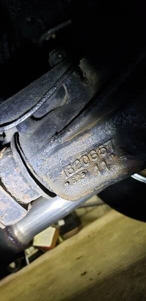

I guess my question is that since this rear end is not out of a 68 charger if I get into it and need parts what do I ask for. Like I said before this seems to be an early differential and I know there were some changes made over the years. So I am at a loss as to what specifically to ask for should I need something for repairs.
Any suggestions or thoughts would be most helpful. Thanks.
From what i see on the internet is that it is the same as a 741 case and parts are interchangable.
You could use DoctorDiff for sourcing any required parts for example, even give them a call and ask about your 657 case.
They will know for sure what you will need and or may use.
Ok thanks.. Im sure its a sure grip but not sure of ratio.
