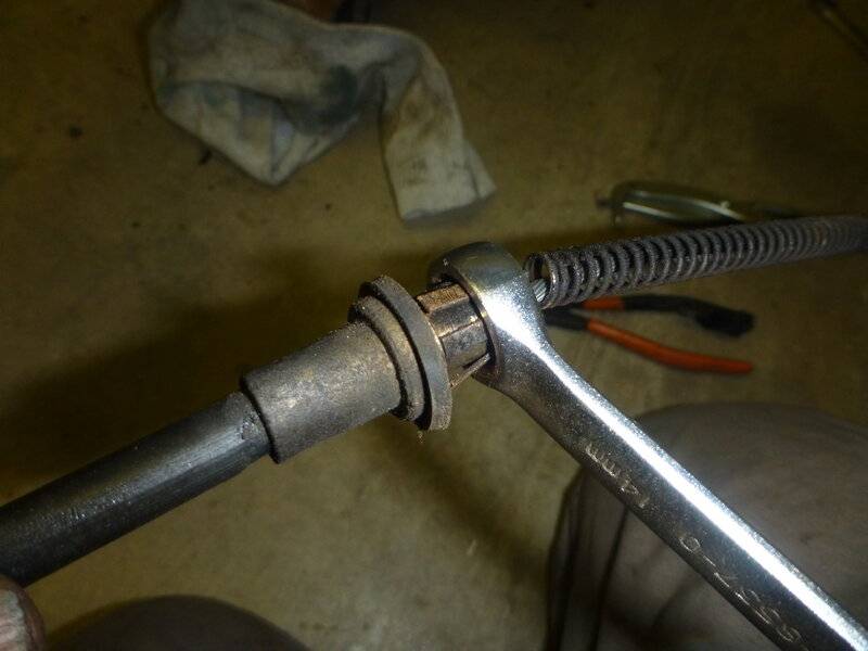

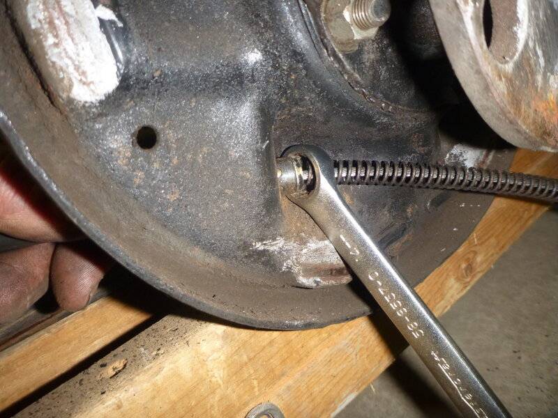

If you are doing the rears, this is how to remove the cable from the backing plate. 14mm box end will depress all the tabs..
