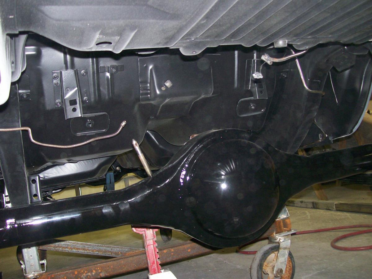

everybody likes a nice booty. by the way all,is this the right place to post resto progress?
Pretty! What did you use for paint on it? Powder coat? Mine looks like crap I was thinking of using a can of $.99 black spray paint next time it's warm outside.
Btw this should be a fine spot for a restro thread.
Yes, this is a good place to post pics. More please!!!!

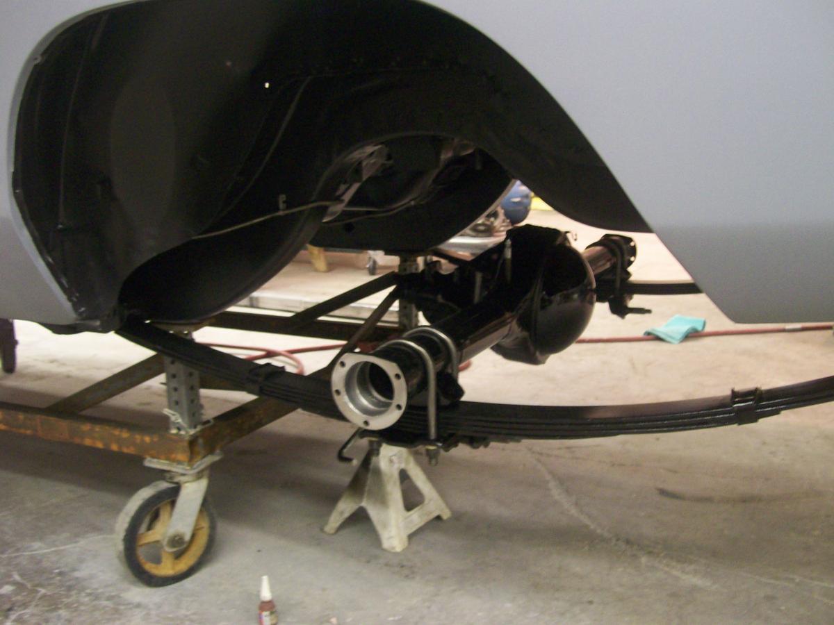

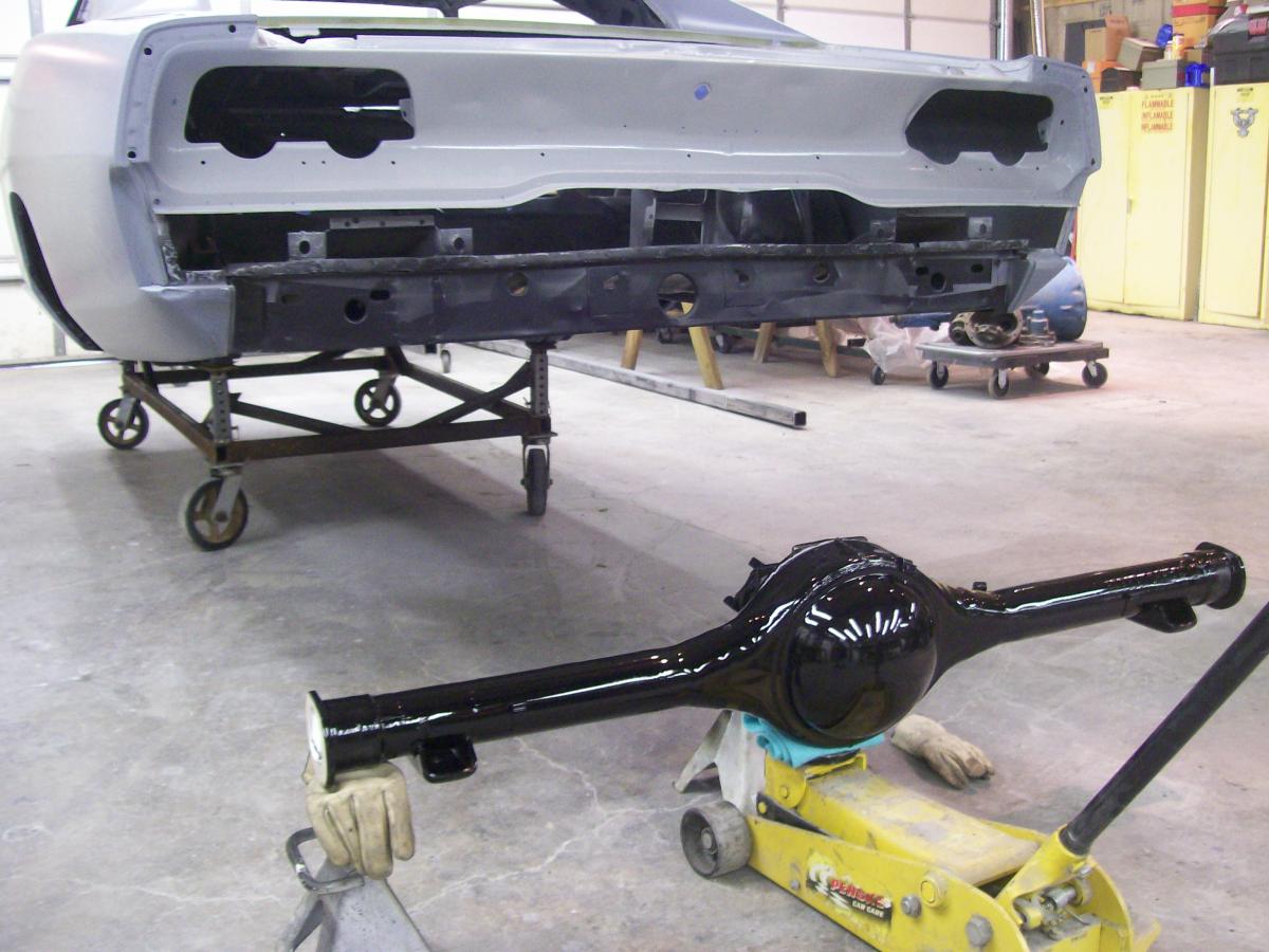

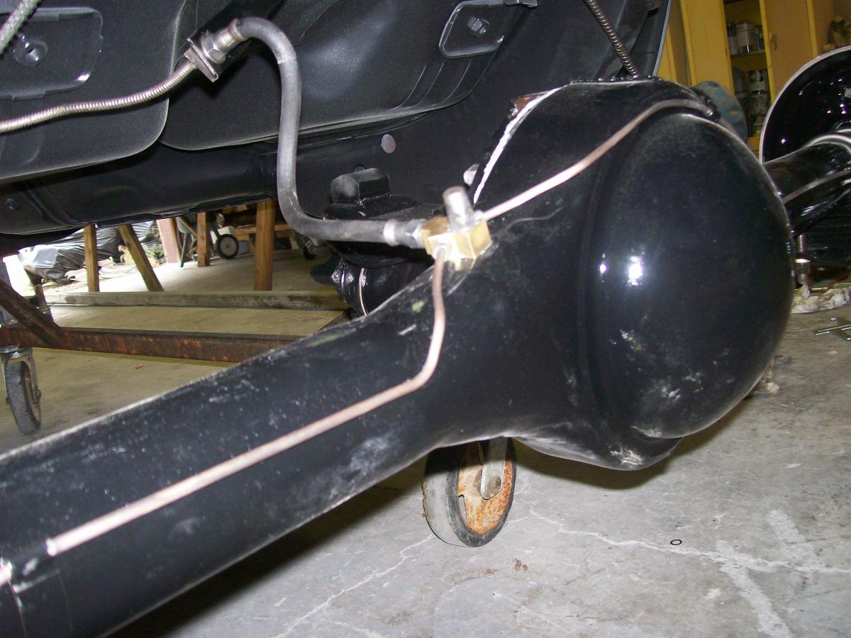

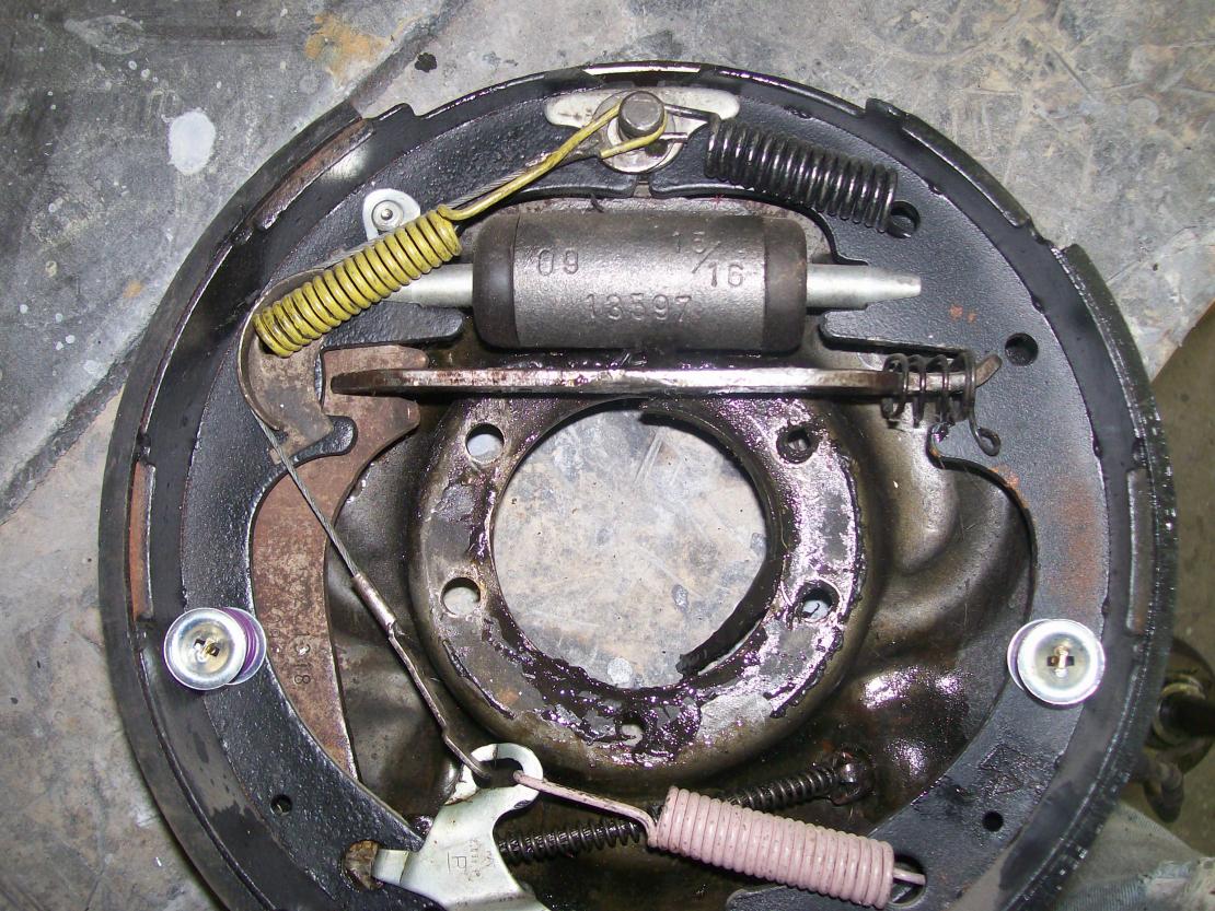

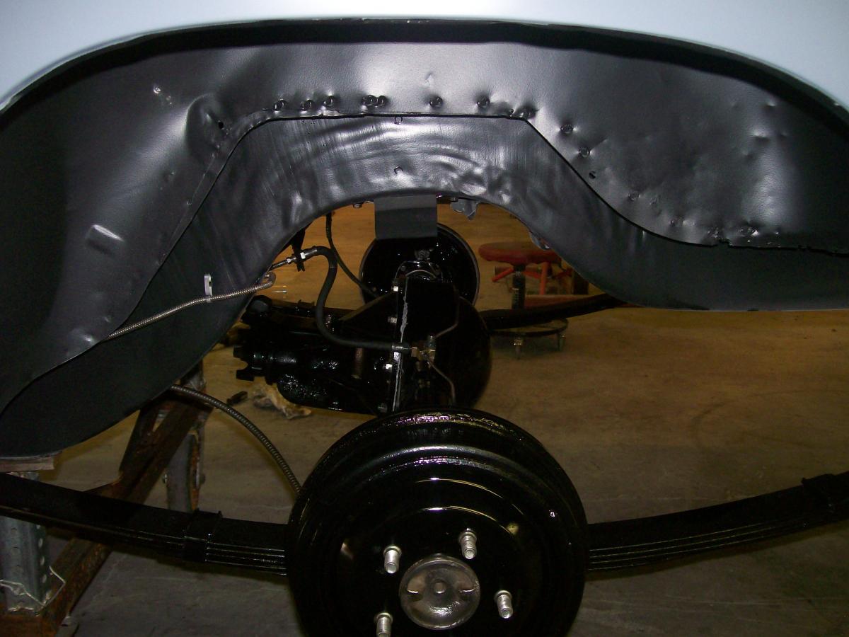

used rustoliem 7779 gloss black,this stuff is tuff as nails, but it takes 36 hrs to compleatly dry,over ppg dp50lf epoxy primer after sandblasting w/fine sand(if anyone else does it this way,be sure to get ALL the sand out of the housing or you will be in the market for a ring n pinion.

Years ago when I cleaned and painted my axle housing I used the Rustoleum with a foam brush. Sanded, prepped and sprayed it with a red primer. It laid out flat and held up like a champ.
When you blast a housing, cover the openings and you won't have to worry about sand getting inside. It's almost impossible to get it all out....looks good!
