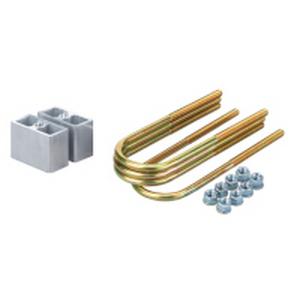

Hey skrcsmith4, I've done what you're thinking about and running it on my car right now without a problem. You can buy the "lowering blocks" in 1", 2" & 3"sizes at most auto parts stores. I bought mine at AutoZone, but I've seen them elsewhere. What you're looking for is the generic truck leaf spring "lift" kits, which because our Mopar leaf springs go below the rear end, make them "drop" kits for Mopars. The kits contain two metal blocks with a locator pin in the center + 4 larger U-bolts, which are luckily all exactly what fits a Mopar.
This is AutoZone's 13-1030 2" kit that I'm using. I "think" I filed down the locator pins just a touch so they fit into the Mopar spring perches. These go for about $35
Just be aware this can change your drive line angle and create a vibration. This is just a possibility and may not happen.
If there's NO angle, the pin bearings in the u-joint caps wear divots into the x-piece, sooner or later.
