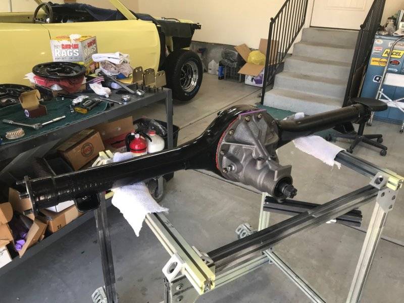

If your going to change it all out, then why not just get the whole package. I got mine from Randy's Ring & Pinion with 3:73 ratio/ 489 (big bearing case).
