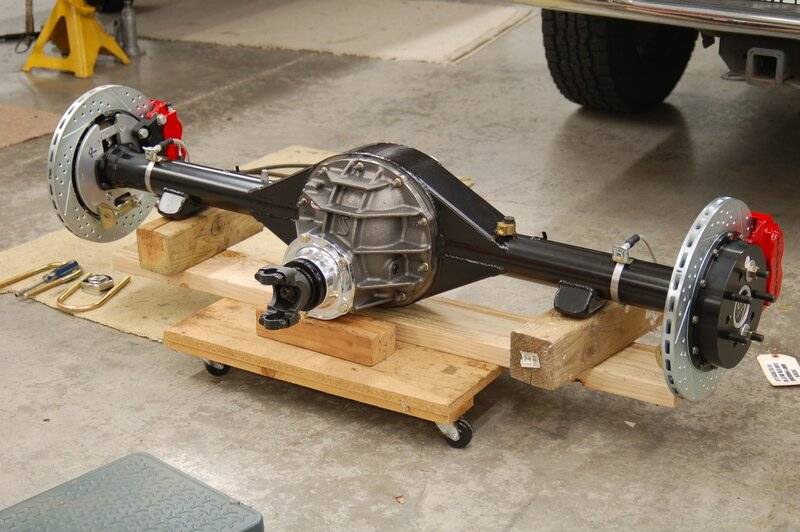

For my Duster I went with a 9 inch assembly from Strange since I needed 3.90 gears. I also wanted to save a little bit of weight and I like being able to pull the gears without having to pull the whole housing out of the car.
I have rebuilt plenty of salisbury axles with out removing them from the vehicle. why would you?For my Duster I went with a 9 inch assembly from Strange since I needed 3.90 gears. I also wanted to save a little bit of weight and I like being able to pull the gears without having to pull the whole housing out of the car.

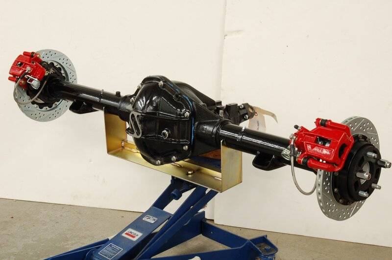

For a resto mod with a Gen 3 in it I assume you're going four wheel disc brakes? With a six speed you probably want some deeper gears out back, maybe a 4.10? Have you figured out the gear splits yet? The S60 is available with a 4.10 but not a 3.90. If you have the Torino ends installed on the S60 then you'll have a larger selection of brakes. I went with a S60 with S Trac and 3.23 gears for my Coronet but fifth gear in my Coronet is 1:1 so I needed the higher ratio.
Okay then you need to figure out some stuff before you can make a good decision on the rear end. As I said before, either a S60 or Ford 9 inch will work for you but the 9 inch has more options and is more flexible. They also tend to be a bit more expensive but they are a little smaller, a little lighter and a little easier to work on. Most pro shops go with a 9 inch when building custom cars but some Mopar guys prefer to stick with a Dana since it looks more correct.Four wheel disc, correct. I haven't figured out anything with gearing yet because I don't know what wheels/tires I will be running. Apparently figuring that our first is the way to go. I am starting from scratch. The car doesn't have anything in it that I am going to use.
