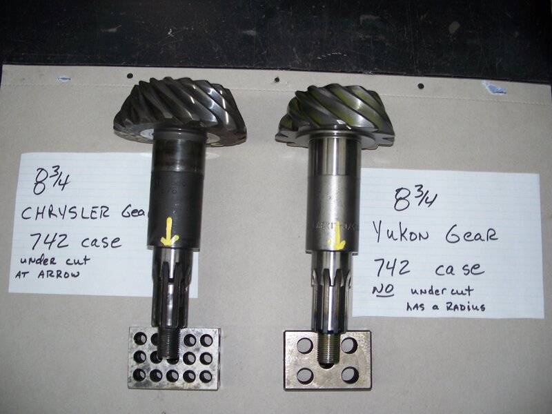

Even if you use the factory thick shim? It usually has a pretty good radius on it. And I've used Ratech kits lots of times. In fact, they were one of the first to supply a crush sleeve eliminator spacer but the first one I got was too long so they got a call from me saying how much too long it was. Once the pinion dept was set, there was no way to get even a bit of bearing preload. Having a lathe, it was no sweat fixing the one in my hand so it didn't slow me down but they sent me a new one anyways. It took a couple of weeks so they probably did some checking and fixed the problem but at least they did it. Some companies just ignore ya.
