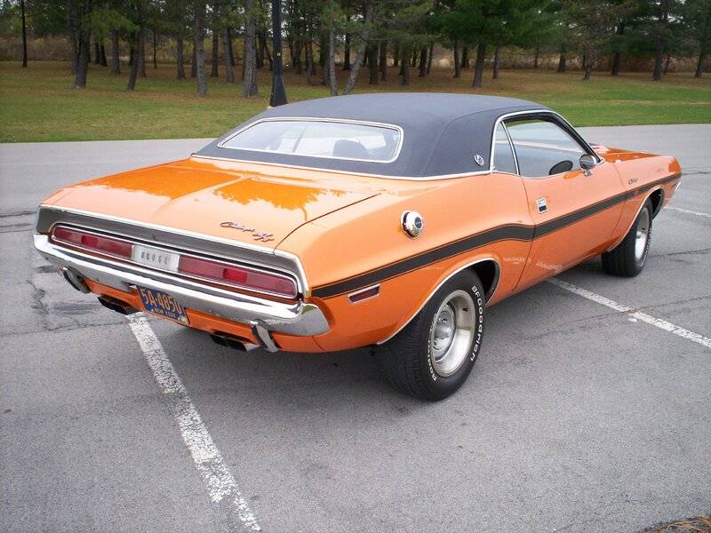

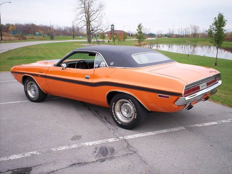

BB-r, I put the MP Heavy Duty, not SS, springs, in my 383 Challenger, and they worked very well, and gave it a nice Attitude for height. Ride was good too...
NICE!!!!!!!!!!!!
Great looking Challenger!!!
Where did you buy them from, and cost?

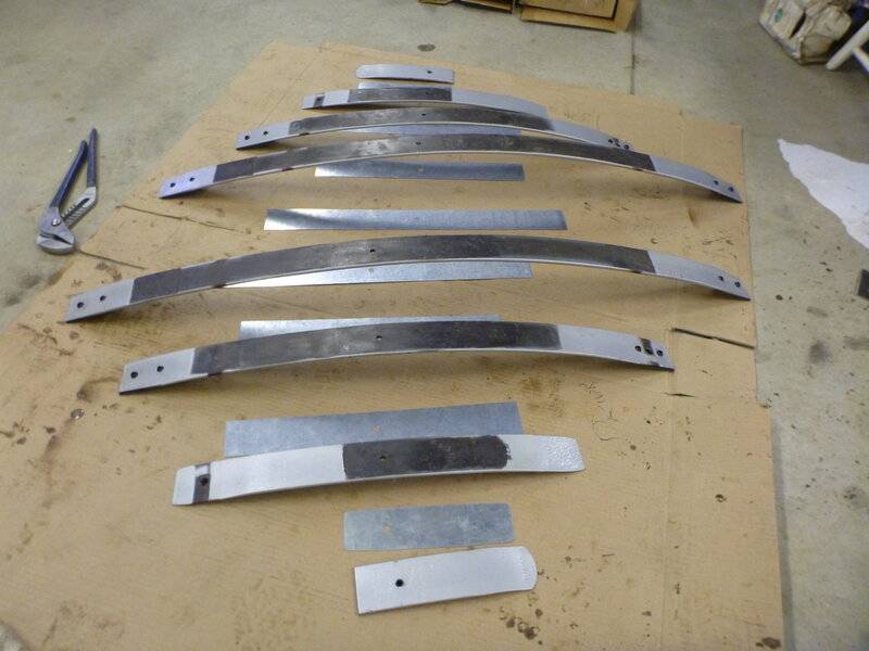

Take them all apart, clean them good, install new galvinized interleafs and plastic wear plates + clamps and you may just be surprised how that sag goes away. I've ran air shocks on my car, at about 35 psi, since 1979. When I restored it I put a new set back on after re and re'ng my 50+ year old leafs. I have about 4 psi in the air shocks and it's finally settled a bit after 500+ miles and considering I should put normal shocks back in place as they're doing nothing..
