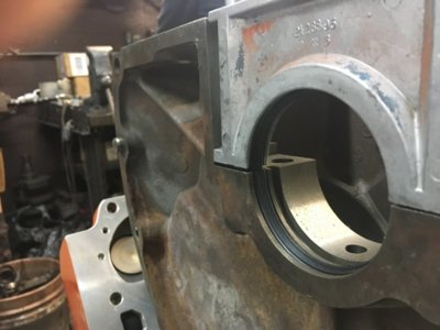

as others have said a windage is a must . i have that oil pan on my stroker it painted black look at my pic and you can see it. your stroker is bigger than mine so think of the turbulence in the pan it will whipped the oil in to a foam and through up on the cylinder walls and burned. is the dip stick in right ? i.e all the way down and seated to block?
