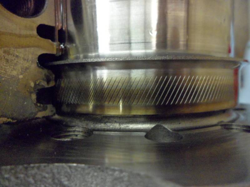

If your crank has knurling it is a rope seal crank, the rubber seals require a smooth surface...
Here's the knurling I'm talking about Mr 69Bee. This surface is only for rope style seals... you can disagree all you want but it is what it is. Neoprene seals require smooth surface. You put a rubber seal on this surface and you'll be doing it again before you know it. I know this from experience.
this is absolutely right full and split lip seals need a smooth surface just look at your trans seals.
The fluoroelastomer split seal, (Viton) can work just fine on the crank with the directional grooves if you follow the installation instructions to the letter.

Yeah, I'm old school and believe in "if it ain't broke, why fix it?" The only thing about the rope seal is that it can dry out if the engine sits for long periods of time. (New ones are not made of the same material as the original ones either. Thank you EPA) Some actually leaked from the factory. The Viton seal won't, or doesn't suppose to, dry out, and was the main reason that it was created.

I believe it has been proven that the lip on the neoprene seal doesn't ride on the knurl. it's contact point is to the inside of the knurl. if the seal is in backwards that's another issue. if the seal is leaking quarts i'd think the underside of the car would be pretty messy.
