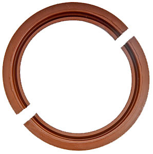

This is the perfect picture and description. Felpro and a tiny bit of RTV I know you sadi you are using rope but that is old school stuff. The picture of the felpros would be how to mount those seals, cuts offset like that.

Horsepower TV had an episode showing how to install the seal. Search for keywords Mopar, big block, etc. They put black RTV in the sides and slid the straight seals half way in installed the round seal with RTV on the mating surface and rotated 1/8 in. offset, installed the cap then slid the straight seals the rest of the way in and trimmed the excess. Let the RTV cure 24 hours before adding oil. Works for me.
