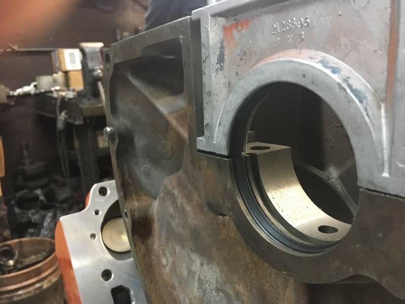

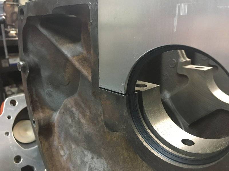

Guide studs installed
You can see how far off both style retainers can bee with the seals at the 9 and 3
I have had perfect luck installing the seals at the 12 and 6 - Zero drips on my Stroker motor , and two other 440 s that I replaced the rear main seal recently
This motor was line honed using a 440 Source Stroker Kit and Billet Steel Main Caps
