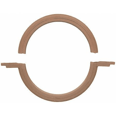

I believe rubber Fel-Pro was used by machine shop. i'm wondering if he installed upper with lip backwards.
Should I go with the Fel-Pro again or have others had better sealing success with other manufactures?
The seal may or may not have been installed properly, but if you go back in, re-install with a Fel-Pro seal. That is all I use, and they are superior to other manufacturers and definitely better that any gimmicky one-piece seal. Pay attention to the install instructions, cleanliness, and good sealer will do the best job for you.

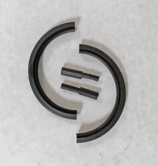

I've also seen this 4 piece from Hughes Engines...
I will suggest you re-read my post, and pay particular attention to this part "...definitely better that any gimmicky one-piece seal...". That is, if you only want to do it once more.
