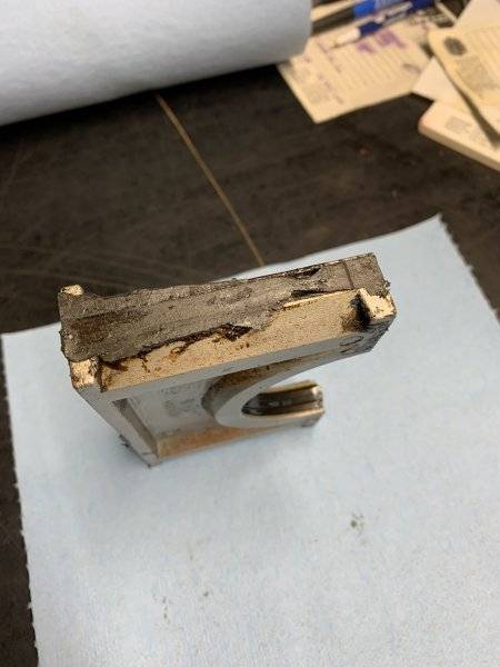

I’m replacing the rear main seal on a 440. So the two piece seal seals around the crankshaft and the side seals seal between the carrier and the block. What seals between the top ends of the carrier and the block? Should I put some Right Stuff on there?
The pictures are the side seals of the carrier I pulled out.
You are the first person I have noticed who has asked this question. I always do put some on there, but a small amount as it’s going to get squished out.
Don’t put any on the ends of the main seal, un-necessary.

Good video. Let me add a couple more tips. If the retainer is clearanced and breaks through to the oil pan bolt holes. Those holes will require sealer. Studs with sealer would even be better. It wasn't mentioned what to do if the seal halves don't line up. The retainer bolt holes need to be opened enough to allow the retainer to move far enough to line up. The retainer will "float" around the bolts. Off setting the seal (3/16"-1/4") will allow the crankshaft to center the seal as the retainer is bolted down. This brings up another issue. The sides of the retainer may not have the same gap to the sides of the block. For this reason I do not use side seals. RTV fills those grooves instead. I use Ultra Grey. And last. Fill the retainer bolt hole recesses once the retainer has been installed. The pan doesn't completely cover the retainer hole recesses. With this method my seals don't not ever leak.
